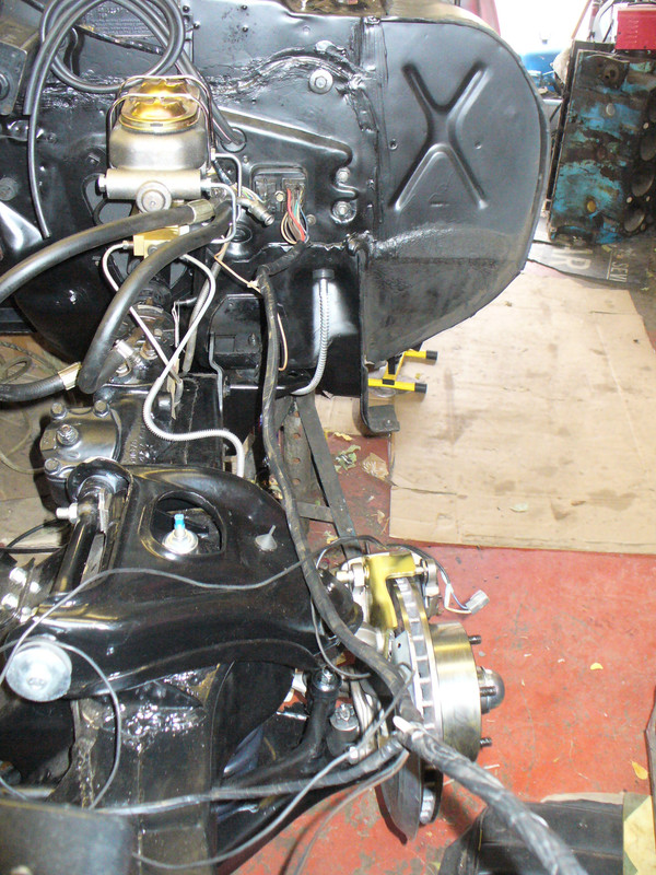

Good advice too on the Silicon fluid. I replaced all the brakes on my 68 Camaro last year and was the 1st time I used silicon fluid. So glad I did as there were many leaks to fix and would have done serious damage. Other reason is that it could easily sit for a year or so in storage so want minimum deterioration.
I'll go ahead and strip the m/c. Soon as I can check the bore I'll know if its scrap or not. Good advice on calipers but I'll probably take a chance and draw the line at fitting the m/c plus possibly the servo.
The XKE is back at mine on a stop over for just the major jobs then back in storage as have another car that I just have to finish ('68 Camaro RS/SS 396 4 speed so it deserves seeing through to the bitter end).
