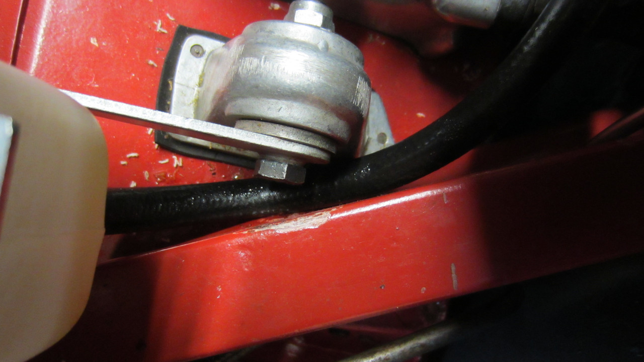

My restoration has been long and drawn out, but I thought I was finally finished at the end of last year.
I had rebuilt the brakes and the clutch system and had installed new reservoirs and rubber hoses.
The clutch hydraulic system has been filled and bled some years back, but I have only recently filled up the brake system with fluid.
All seemed fine at first, but the seals in the servo appear to have a problem and the driver side (RHD) brake reservoir is emptying and the servo one has overflowed, spilling fluid down the bulkhead.
As if this wasn’t bad enough, I have noticed that both the hose from the clutch and brake reservoirs and the hose from the reservoir to the servo are sweating fluid.
I have also noticed that the clutch fluid is darker than the more recent brake fluid.
I have concluded from this that the brake hoses may be deteriorating internally. The reservoirs look fine.
I noted from the forum that it is necessary to get Cohline brake hoses as anything else weeps.
Ah, I thought, I must have bought the wrong hoses all those years ago, so ordered Cohline hoses from Merlin Motor Sport.
I have been looking back through some old invoices and noticed to my horror that the ones I have been using are Cohline (2337), which I bought from Merlin Motor Sport some years ago!
Has anybody else bought Cohline hoses and had a similar problem?

Hi Paul...does your hose say cohlin on it.....did they supply the wrong hose....Steve

Hi Paul
This is interesting because I have just noticed the same problem.
I bought Cohline for my car and fitted it on all 3 reservoirs (Series 1 3.8 Kelsey Hayes set up).
Now it appears that the clutch flexible pipe is sweating, although the brake flexible pipes appear fine.
I have my pedal box dismantled at the moment so may replace it all but I did question whether I'd actually got the Cohline, despite it being printed on the pipe.

It should have 'Cohline 2337 stencilled into the outside...Cohline make many grades of tube ....possibly you got the wrong one by mistake.
Other possibility is that the tube is not sweating but the reservoir has cracked at the bottom and fluid is gradually seeping out and flowing down the outside of the tube. I've had three reproduction reservoirs (round 3.8) split where the outlet joins the base. It looks as though the tube is sweating but it is not....There are several threads relating to the reproduction revervoirs. Afraid a lot that have been sold by all the usually suppliers over recent times have been substandard and not fit for purpose although things may have improved.....

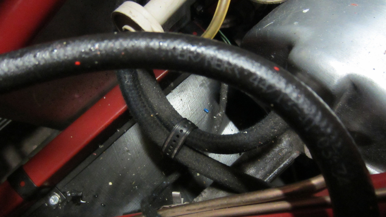

After posting my question, I wondered if it was even possible for all of the hoses to be sweating at the same time. After all, the clutch one had been in use for considerably longer than the brakes.
I had another look today and I can see no sign that the reservoirs are split or leaking.
However, I have established that the hoses are Cohline , but they are Cohline 2190!
https://www.merlinmotorsport.co.uk/p/ru ... -2190-0615
Which appears to be fuel line.
I have checked my invoice again and the order was for 2337, so the wrong hose was supplied.
The new hose is however correct.
A costly mistake not checking my orders
Thanks again,

For completeness, I did use Cohline 2337 and, you are correct, it was a defective "new" reservoir.cactusman wrote: ↑Wed Jan 20, 2021 9:07 amIt should have 'Cohline 2337 stencilled into the outside...Cohline make many grades of tube ....possibly you got the wrong one by mistake.
I have now reconditioned my original reservoirs and will be re-fitting them this weekend.
