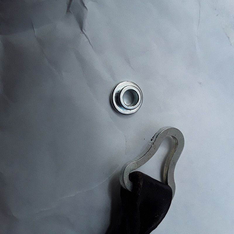

Hi chaps,
I've just received a pair of hood tie down straps from SNG Barratt, the ones that attach to the hood bow and swivel to hold the hood down in its folded position. At over £100 not cheap but their sales guy assured me they were premium quality items.
A few questions to help me fit them properly and even better if anyone has pictures.

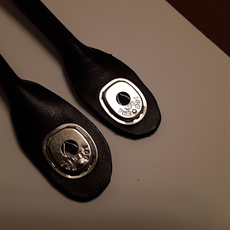

Can anyone confirm the correct shape of the ends that have the lift the dot fasteners as my new ones may need trimming to the correct shape . At present mine are more the shape of a 50p piece where they have been roughly cut to size. I think the final bit of shaping is up to the customer so if anyone has a pic of an original that would be great. Also should the lift the dot fastener be central or offset and slightly at an angle. Are they handed as one seems a significantly different shape to the other?

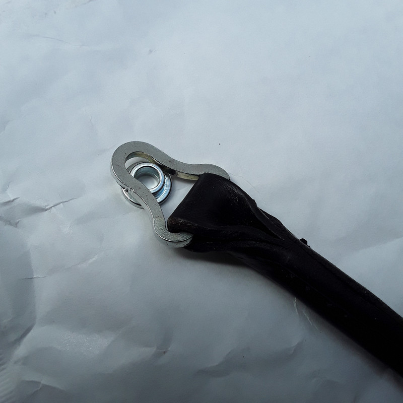

Moving on to the other end that is permanently fixed to the hood, should the small shouldered spacer washer fit inside the strap end. Mine doesn't so when you tighten it, it prevents the strap from swivelling. Do you just leave the screw loose so it can swivel on that. The only problem with that is the strap end then jams on the screw and washer as it turns.
Can someone confirm that my strap ends are angled the right way , in towards the hood rather than out from the hood. The sharp and jagged edges of the metal strap ends are going to damage the hood material. I'm thinking it might be better to get new ends made and washers that fit properly.
The central part of the strap isn't too bad, I think I maybe need to make new ends and fixings . I'm optimistic that I have the first 10% of a strap that will work so if anyone can supply pics or suggestions on how to make the last 90% that would be hugely appreciated.

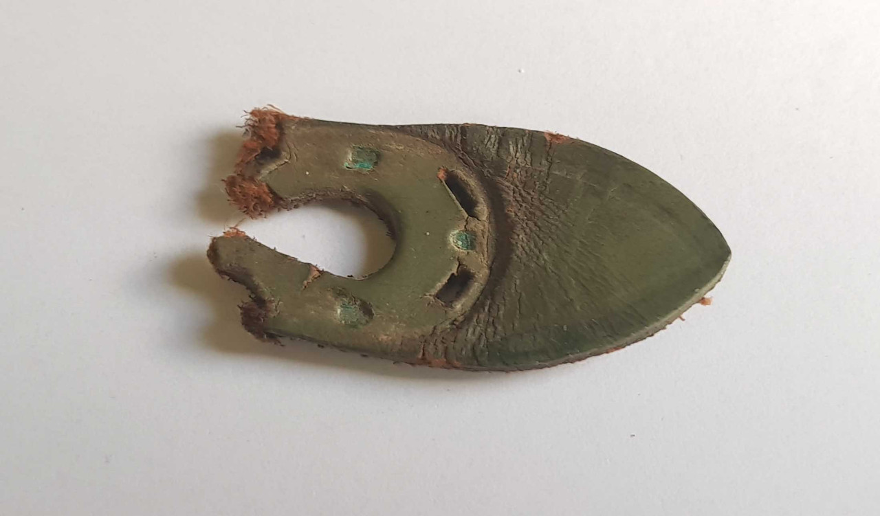

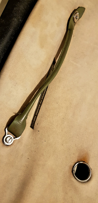

Simon, those look appalling on so many levels, and shouldn't grace an E-type. As stated, the colour should be an olive green. However, the end shape should be more pointed - the shaping on the SNG ones is very bad, and also the end loop looks rough as anything. I have attached the only handy photo I have of one of my straps - this was actually made for me years ago but was an exact copy of my one remaining original strap. I actually mixed some leather dye to match my original sample and then re-coloured the new one ( I guess you could do this with the black ones, but I suspect they would look even worse) I have a broken off end somewhere and will take a picture if I find it. The lift-the-dot should be central, and straight. In my opinion I would return these to SNG, certainly considering the cost - not sure if you can make much of them as they are, and surely they aren't sold on the basis that the customer trims them to shape, since if you are buying them you probably don't have an original to copy! I've just found an old thread I posted on, with a good shot of an original strap that another member posted. You can see how wrong the SNG ones are.
http://forum.etypeuk.com/viewtopic.php? ... cf4cf39d78

The stepped washers supplied by SNG Barratt do not fit inside the metal ends of the straps again supplied by SNG Barratt. They just don't seem right. I have resigned myself to making new ends but want them to be as per the factory originals. If anyone has detailed pictures of the original ends and the shouldered washer, that would be a huge help. The leather ends with the lift the dot fasteners I can trim into shape again if I have pics
The fact I should need to do all these alterations to one of Julian's "premium" products is an altogether different discussion. :lol: Joking apart, as mentioned above, it does look vaguely like a hood hold down strap, I just need to improve it a bit. I'll post more pics up later.

Richard that's great thanks. Can you confirm that the end that fixes permanently to the hood and swivels, sits around the shouldered spacer washer. That is that the shouldered washer sits inside the metal part of the strap so that when the screw and washer are tightened, the strap rotates freely. I suspect the SNG Barratt washers are too big or the strap metal end the wrong shape .
Monkeyfinger
Posts: 301
#6 Re: Hood tie down straps BD20660
Post by Monkeyfinger » Tue May 11, 2021 11:12 am
Yes, the straps fit as you would expect, with the top hat washer underneath, then a flat washer on top (at least mine did). Not sure that the original washers weren't plastic/Nylon? I think I 3D printed a replacement on one side - they are a pivot point so need to be free moving, but don't really take a great load.

That's what I assumed was the case. I think the next step is to get new ends made. Unfortunately as you say, I didn't have the originals otherwise I would have done what you did and refurbished them. I don't know if there's a market for ones that are to original spec and fit but I can certainly get the ends cut in stainless easily enough.

From the pics and other feedback I've had it is clear the SNG Barratt ones are completely wrong. In fairness they do at least have a lift the dot fastener. In conclusion I've bought two lift the dot fasteners for £100. :lol:

However, if needed, here's a detail view of an original strap end - I think the SNG catalogue item image is a reasonably good match. No idea what they then managed to do to achieve the sorry item that the OP received. Surely, copying a 2 dimensional piece of leather would result in a half decent end result without too much effort? The fastener is obviously meant to be central and aligned, and the profile isn't even close.
