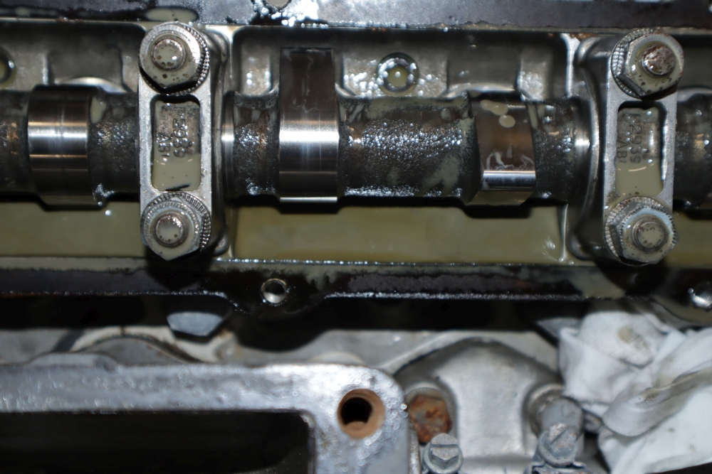

a friend brought his 74 V12 roadster to check the valve clearance.
When removing the cam covers I found a beige water/oil emulsion instead of engine oil.
I was advised to renew the head gaskets and pulled the heads but nothing seems to be wrong with the gaskets.
(in hindsight I think there was no need to remove the heads except to remove the timing cover)
What else could be the most likely culprit?

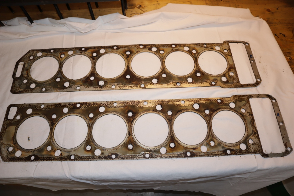

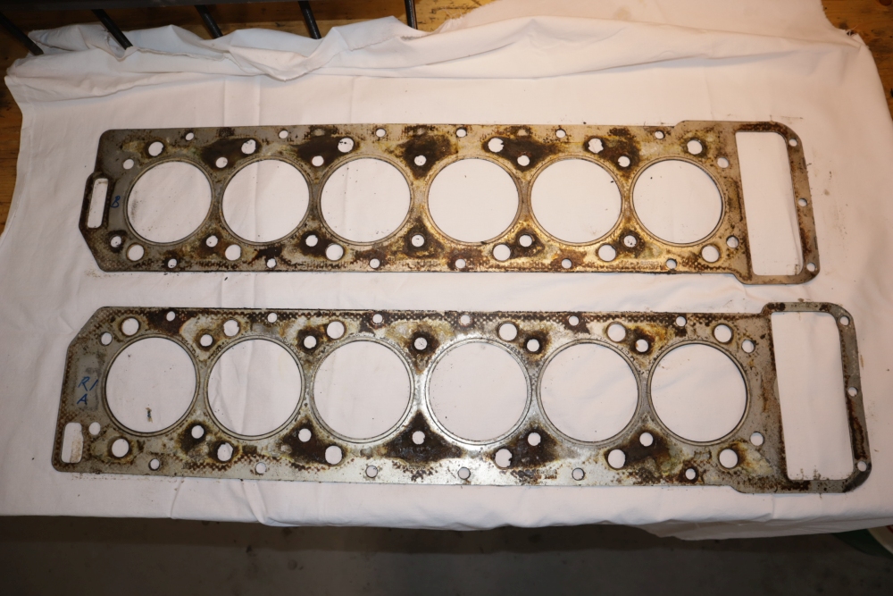

I have to admit that I havent seen defective V12 gaskets yet, maybe the are not ok,
so here are photos (top and bottom sides)

I'm not very experienced with the Jaguar V12 engine, but in a general sense water contamination in the oil is head gasket one, two and three.
Even if the steel gaskets looked ok I'd want to be sure that the heads weren't warped (by overheating, for example), nor were they cracked, before reinstalling them.
I can't comment on the likelihood of liner seal damage; Marek would know far more than I.
I think that if I was in your position I would have the heads crack tested and skimmed flat, reinstall them, then fill the car with oil and water (not coolant), run it and see what happens. You could pressure test the cooling system before running the car.

With that last post, it now just sounds like a bit of neglect and corrosion over time. Unless you can see an obvious squigly black line of a crack somewhere, I'd simply clean things up and refill with water as Bill suggested. The head gaskets were the most likely path since they are steel and coolant corrosion inhibitors don't work forever.
