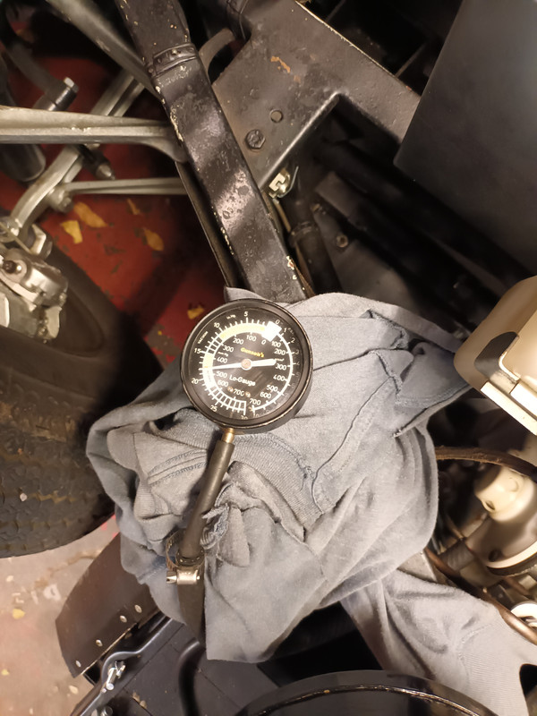

#7 Re: Brakes slow in releasing
Stripped out air valve. Reaction valve piston was a bit stiff.
Moved back and forth by pressing the brake pedal to move it out and pushing in with a rod.
Plate in front when I pressed brake pedal to stop it flying out.
Added as much rubber grease as possible without completely removing the piston.
It's a firmish push inwards but does move.
Refitted and tested with vacuum gauge on the air valve output connection to the rear of the servo.
Engine idling. Holds a good vacuum and drops to zero and returns to vacuum immediately when brake pressed and released. Should have done this 1st to save on dismantling.
Not road tested but I think I have eliminated this item.
