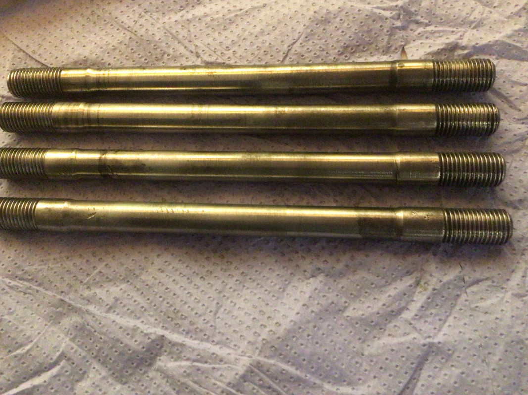

First time I’ve got an image to work !
These are my 4 longest studs

christopher storey
Posts: 5698
Joined: Sun Mar 09, 2008 3:07 pm
Location: cheshire , england
#5 Re: Head studs
Post by christopher storey » Thu Nov 09, 2023 5:00 pm
Tim : just buy a single shouldered stud ( it is a different part no from the rest ) and place it in the no 2 position ( i.e 2nd from front ) on the left side . They are not very expensive
tim wood

tim wood
Posts: 1219
Joined: Fri Nov 20, 2009 6:52 pm
Location: Leighton Buzzard UK
#8 Re: Head studs
Post by tim wood » Thu Nov 09, 2023 10:56 pm
Thanks Andrew, I’ve got that.
My question is why don’t I have a shouldered stud?
My only thoughts are that the head has been off before and someone has used an incorrect stud.

tim wood
Posts: 1219
#15 Re: Head studs
Post by tim wood » Sun Nov 12, 2023 7:06 pm
I think I may have solved the riddle of the 170mm studs.
They are part number C42355 used on some XJ6 engines with the pressed steel lifting bracket. This bracket is thinner than the cast unit hence a shorter stud is used.
My head is original to the block so either the studs have been changed or were used when the motor was made.
I think that the head has been off before ( no lock wire on the cam bolts is an indicator) so my guess is that these have been changed at some time. This also explains which they show much less discolouration than the other (short) studs.
I’m not prepared to use studs which I know are not correct
So it looks like another order to SNG.
Tim
