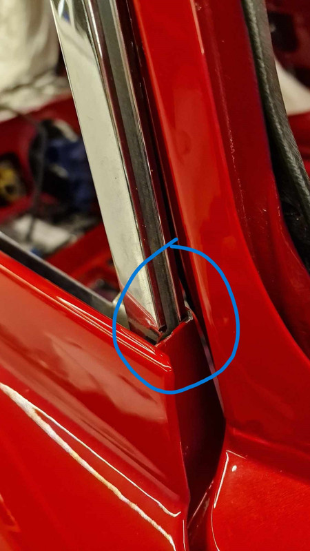

Hello, I hope there is someone out there who has their E-type LWB, specifically series 1 2+2 1967 is possible, who could share some photos of their doors and the window frame fitment. (Photos of the seals around the frame are also very much wanted)

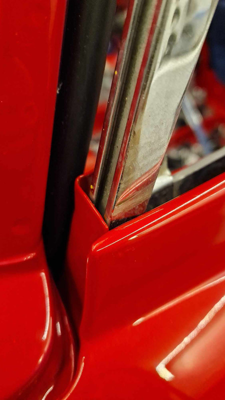

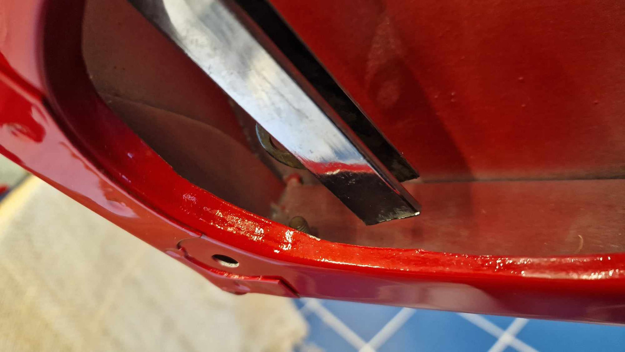

Both doors are a bit too wide to fit inside the door. Especially, the left door. After some modifications to the door I have managed to squeeze it in, but the cut-out in the frame is resting on the door which has cracked the paint... is this section supposed to fit inside the door, or is it supposed to be ground / cut to be over the door? please see the images and maybe share your own if you have any.
My doors are new and the chrome has not been installed in these doors before. The door and car are painted, so I don't want to cut in it, but the frame will need to be re-chromed. Hence, I can and have already done some modifications to it.

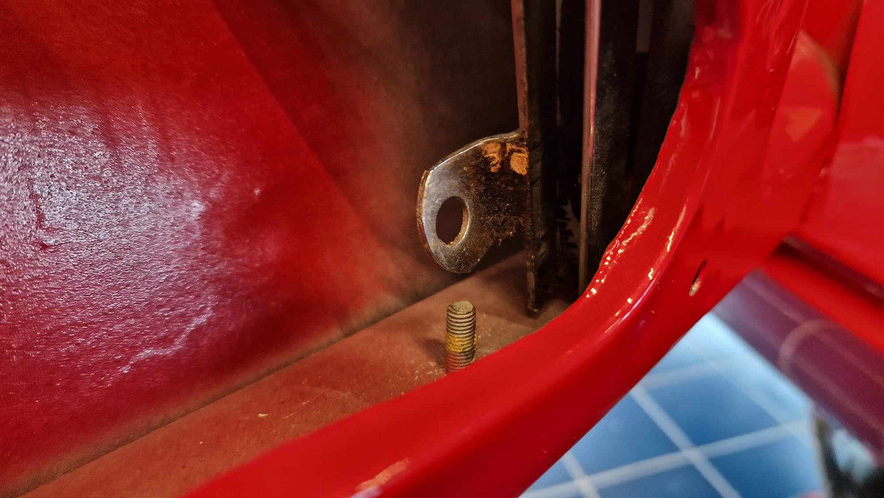

And is the stud / bracket which holds the window frame in place identical for both the front and rear? the length do seems to be different with some margin.
Any help / photos of general LWB window frames would be much appreciated to help with the installation.

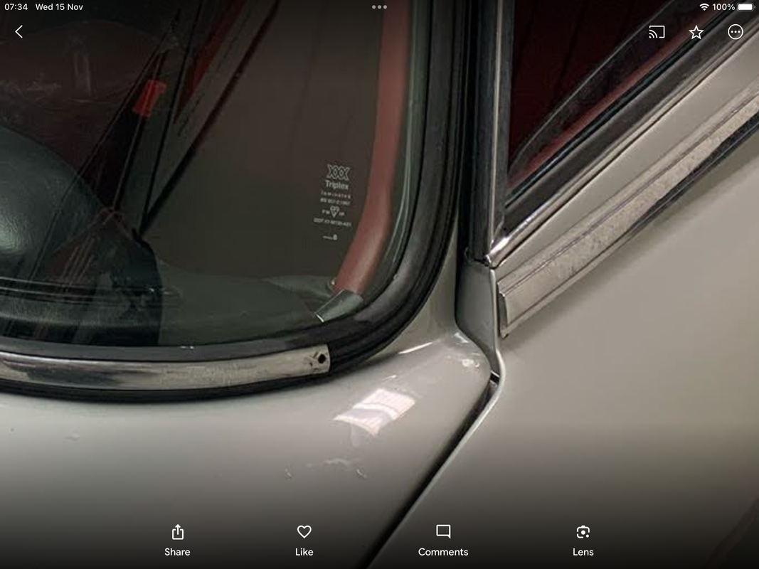

Hi Thim (Is that your name?),

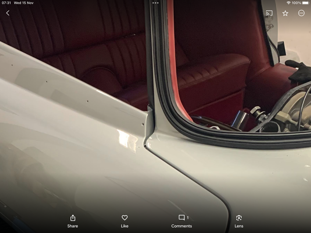

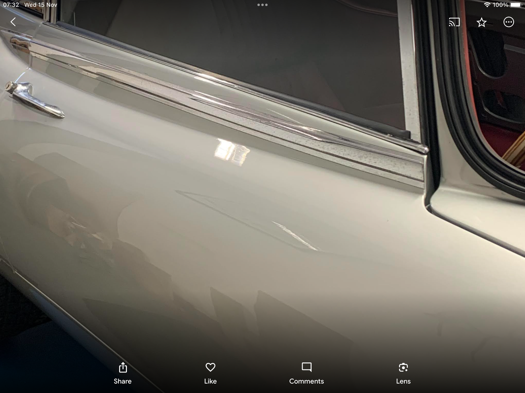

I recently finished building a 67 2+2. I have attached some pictures of the door frame fitment in the area you highlight. There is a chrome trim which fits down the side of the windscreen that should fill that gap to match the door.
I can’t remember the length of the studs in the base of the door, but they should probably be about the same length as the two brackets they bolt to are of the same thickness. Either way, the length is not critical.

Thank you Simon. This is amazing, I'm struggling on the door part since I did not have any doors on my car when I started the restoration, 11 years ago ...Simonpfhc wrote: ↑Wed Nov 15, 2023 7:41 amHi Thim (Is that your name?),
This helps, but du you have an photo of the door frame were it meets the door at the A-post? There is a section which which is partially grinded off from factory which seems the part that take up my wiggle room... I will see if I can get some details photos in the weekend.
and yes, my name is Thim

Unfortunately, these are the only photos I have.

#7 Re: Series 1 LWB / (2+2) window frame fitment
Pragmatically, your new doors don't fit your window frames. This is not unheard of.
From your photos, it does appear that your doors fit the body.
I think the smart thing to do is to grind your window frames down to fit your doors. Horrible, I know, but they are chrome plated brass I think, and corrosion shouldn't be a problem.
The length of the two mounting studs should be ok. When adjusting the window frames to fit the bodywork it can be surprising just how much leeway is required at the bottom to get the top of the frame in the correct position.
Once you have this all done the chrome cover at the top of the door should cover a multitude of sins.

#10 Re: Series 1 LWB / (2+2) window frame fitment
Thank you Abowie,
as you say I need to adjust my window frames indeed. The doors was fitted to the car before paint, but I forgot the chrome frames. I have made them fit the car not, by some "gently" use of the 500g Hammer and a fingerband-grinder :) They need to be re-chromed anyway.
But which top door cover are you talking about? I don't have any sins (at least not yeat) in the paint job, are you thinking of the top inside part of the door itself? Can I expect that I need to cut/grind away some sheet metal to make the door fit? Any elaboration of this would be appreciated. I plan to send the frame to re-chrome in early 2024 as I have made them able to fit inside the door at least. :D
Jaguar E-type s1, 1967 2+2. Under restoration by myself, slowly seeing the light at the end of the tunnel

The chrome door handles are just bolted straight to the painted metal with no seal. That’s how they came from the factory.
The door cover Andrew mentioned is the chrome trim that goes along the top of the door and also the chrome that covers the side of the windscreen also helps cover the door area.
