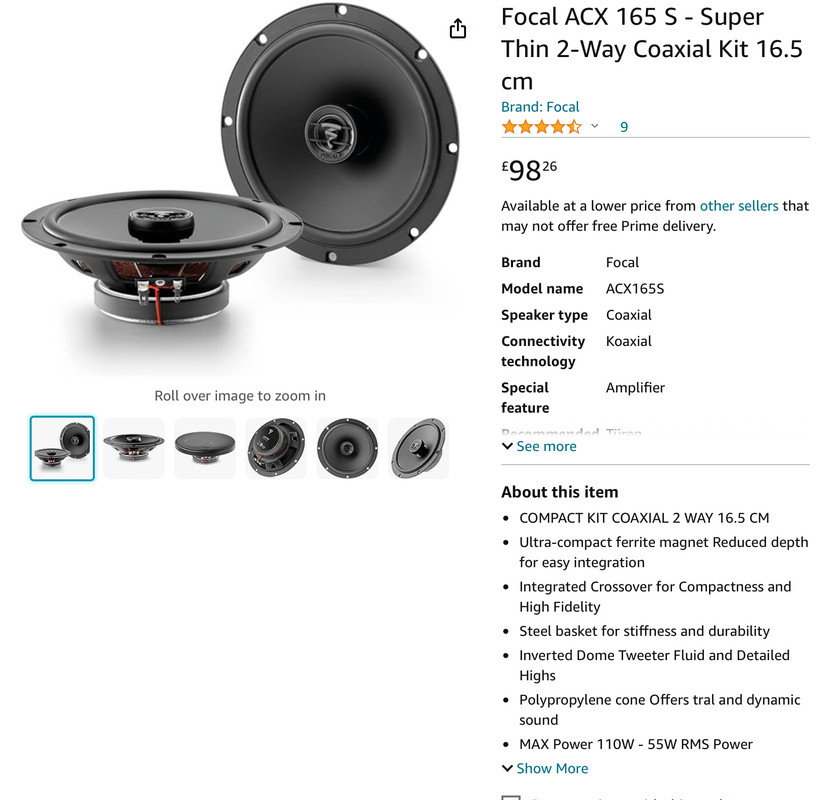

I’ve recently changed over to Focal speakers after some deliberation over correct fitment. I did a lot of homework, particularly as console space is tight with original Blaupunkt and amplifier.
I did open out the (4) speaker mounting holes slightly just to give me some ‘wiggle’ room but this was minimal.

Thank you Steve. I shall take a closer look at these. Do you recall whether the 16.5cm was the overall diameter or the distance between fixing holes?
#4 Re: Series 1 4.2 Stereo Speakers
Diameter or diagonal across the full speaker, Andrew.
As you will note from the picture above, there’s plenty of flat mounting ‘lip’ to open up slightly for the four console studs and corresponding nuts to hold onto. Also doesn’t damage the all important speaker membrane. My console is original 1965 S1 4.2, which may well differ from others.

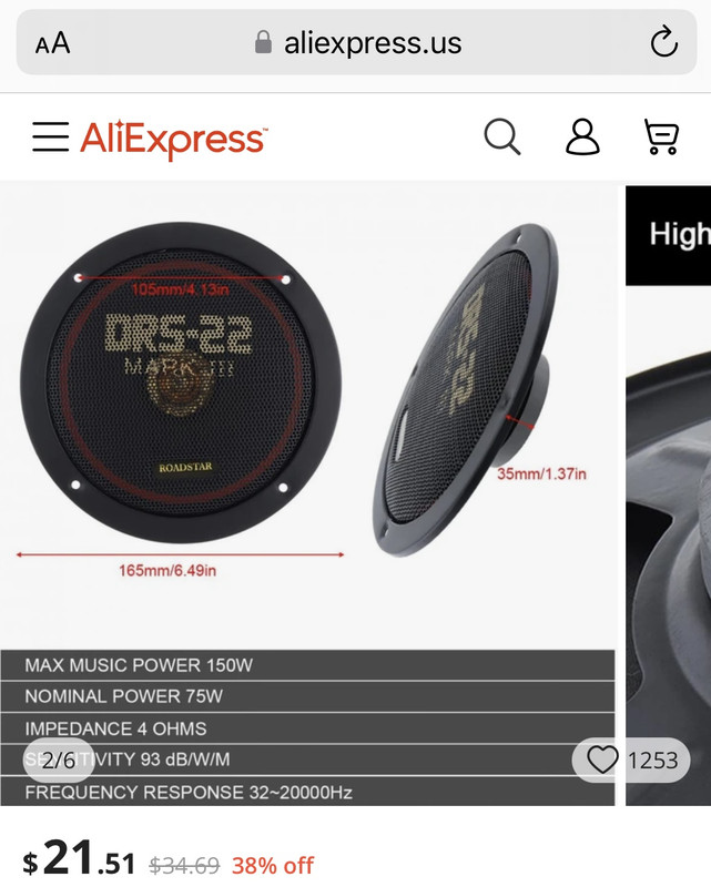

Also looking at this topic for my project. Found the Roadstar DRS-22 with installation depth of only 35mm, so it would fit also with a larger radio. Not sure about availability in EU/UK or quality. I have seen them on US Ebay and Aliexpress.
