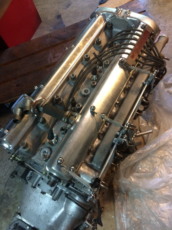

I have a 4.2 fhc series one undergoing full restoration.
I have rebuilt the engine and recently started it for the first time. It was a slightly difficult birth, I had the ignition timing out by one plug but once that was sorted the car fired up. All seemed ok but due to a faulty otter fan switch the fan did not cut in and the car boiled its water and threw a lot of water out. When I tried again the car started and seemed ok. It has now run in total for probably an hour and each time starting it has got harder - the engine needs churning over for ages before reluctantly starting. Until this week it seemed to be running ok once started when it seemed to be down a cylinder so I did a compression test and found no compression on no3 cylinder and only 60psi on the others. I borrowed a cylinder leakage kit to explore further and found that no3 was leaking into 2&4 and all others were leaking. At this stage I decided to remove the head and found that the head gasket has failed between all 6 cylinders. There is evidence of oil in the bores but little evidence of burning oil - no blue smoke.
The engine has had all the machine work done professionally and includes honing cylinders - original standard pistons with new rings, crank regrind mains and big ends,head decoke surface grind, 6 exhaust valve guides and seats , reface all valve seats and 6 valves ,new exhaust valves etc.
I built the engine myself as carefully as i know how but now have this problem.
A professional engine builder has seen the head and thinks oil may be coming past the new rings and suggested pouring petrol on top of the pistons to check for leakage. I have done this with running in oil and 10/40 oil - no leakage, with petrol just covering the crown of the piston, the petrol takes approx 8 minutes to leak away. This didn't seem bad to me but he thinks it is and suggests taking the engine out and starting again. This is obviously the last resort as the car was due to go to the trimmers this week until this happened.
I,m sorry for the long epistle but thought you would need the facts if you are to be able to help. If you have any thoughts or advice it would be most welcome to a very dispirited enthusiast.

The odds are that the basics are still fine assuming you flush with clean oil etc. Keep it simple. Replace the headgasket, time the valves and ignition properly and check the compression again after you've run it briefly.
Keep the valves clear of the bench if you have the cams fitted. Do check the head face for flatness. Assuming you did not fill the header tank full (which would overflow even at normal temps) the engine should have survived a bried overheating episode in the workshop.

with all 6 cylinders showing signs of cross leakage in such a short time of running and the fact you've had the head skimmed i'd suggest first checking the block surface if it has'nt been decked,also looking at head studs bottoming out in the domed head nuts,have you fitted new studs? correct washers?was it a payen gasket?-and carefully inspect the failed head gasket for even clamp pressure marks --let us know what you find.

I'd check that the head is still true, put on a new head gasket and see how it goes. You don't really have that much to lose; if the engine has has other heat damage it's stuffed anyway. If it's OK then away you go.

As Steve 3.8 says, this failure has to be a consequence of insufficient clamping force . His advice about checking for the studs bottoming out in the dome nuts is very important . I should get a digital caliper and use it as a depth gauge ensuring that with the D washers etc installed, the free length of stud exposed is fully threaded , and is at least 100 thou less than the depth of the dome nut threads . As far as the pistons are concerned, I prefer your view to that of your mechanic - I doubt that there is anything significantly amiss . However, re-ringing is at best a dodgy business, so don't be too disappointed if the engine uses oil - and anything better than 150 miles per pint is quite normal - even the best will only do 300 mpp or thereabouts in most running

Thanks guys, I have checked cylinder head studs for length compared to the height of the head and all seems well. Will check again when engine man has rechecked the head. The gasket does have signs of compression all along so I feel it leads back to the head. The block appears to be flat can only check with a simple straight edge at the moment. The studs are the original but all new domed bolts and washers. With the domed bolt on I have measured the distance from the underside to the block and there appears to be approx 3mm of clearance so the head should nip up ok. Gasket was supplied as part of head set ( and bottom end set ) by E type specialist. does't appear to be a dodgy supply.
The engine machine shop checked all components before machining and advised not to have new pistons but to rering so that's what I did.
thanks again and I will let you know what the head man says when he's finished checking.
