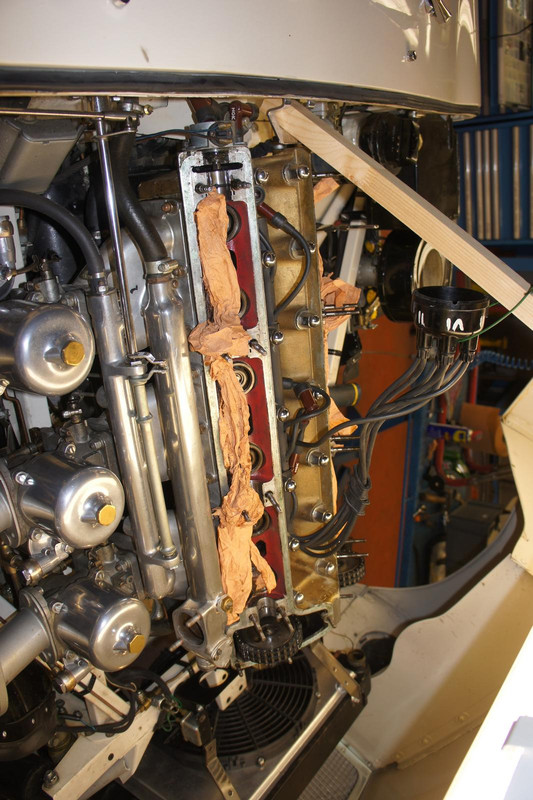

But ......... exactly where is painted ?
Is the 1/4" lip below the cam-covers painted, on the outside above the manifolds ?
Should that be left semi-polished/slightly rough, or painted, please ?
PS I was about to do the "valley" completely wrong, see the masking tape, as for some reason I remembered just one of the cars from the Factory Fit where the paint stopped at the head-nut level, so that the vertical walls above the nuts were as-machined and not painted.
Some how this seemed to make production sense in that if the casting were painted before any machining and polishing, then anything that wasn't machined or polished ............. would be painted.
But I can now see that all the others have the whole valley painted, head-nut seats and walls above included.
Alright, Alright - only an hour wasted, I was getting quite good with the masking tape.

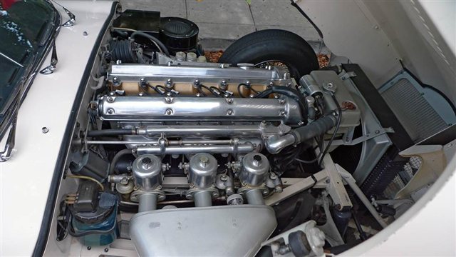

Post by Mich7920 » Mon Nov 26, 2018 6:23 pm
Hi Steve,
It's look like this.
Hope it's not a Special French XK serie...
Mich

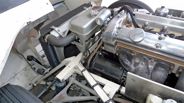

This is the origin of my doubts.
In the Factory Fit series there is a section relating to
"a totally original and un-restored 1963 OTS #879032 having covered 29k miles and had one owner until 2005 who fastidiously maintained it"
http://forum.etypeuk.com/viewtopic.php?f=4&t=2006
The pictures begin at #131 out of #284, and show a cylinder head that is unmistakeably not painted any higher than the machined head-nut surfaces.
This is the only example that I can find, amidst admittedly inumerable examples of the contrary.
My own head, pre-rebuild, had those zones painted, albeit somewhat apologetically.
Is that 1963 car in the Factory Fit a freak, and did "fastidiously" maintaining it maybe include re-painting the cylinder head ?
I'm about to pull the trigger (Ed- you mean push the aerosol-can button) on my "Very Rare" 3.8 head-paint finish, as I personally prefer the looks of it, but do need to weigh up the risks of excommunication before I commit.
