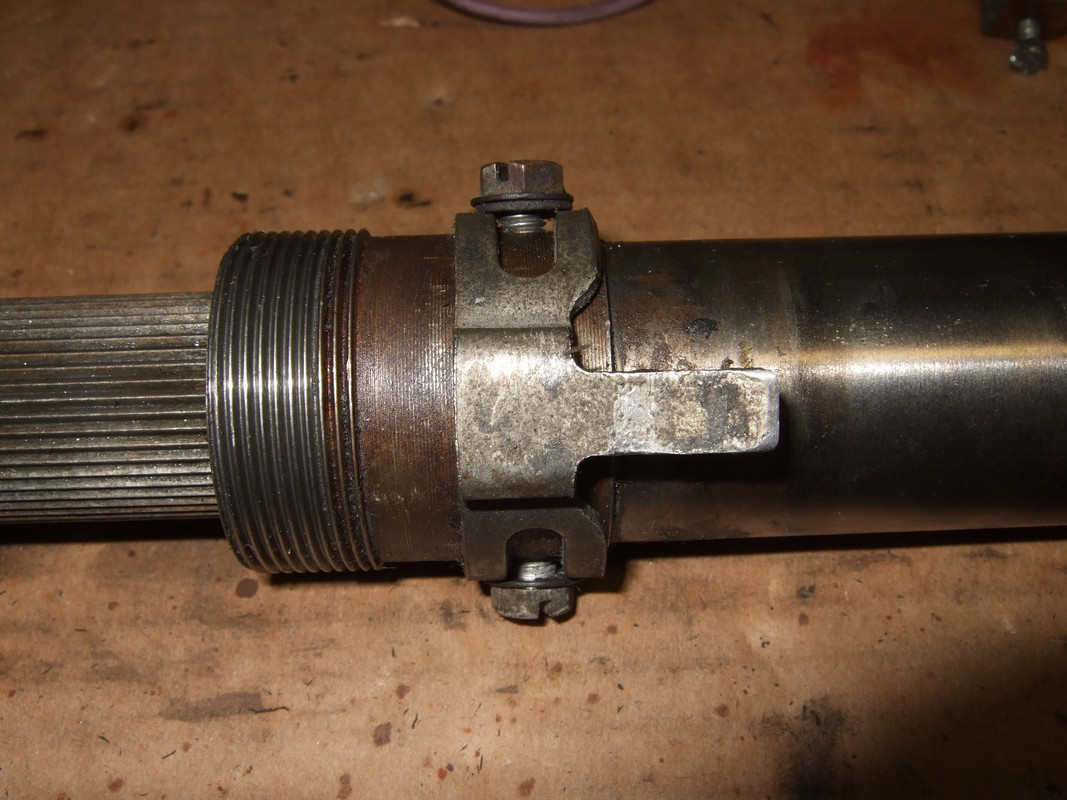

I have one more question on the cancelling ring issue. It seems my striker has the 'tongue ' broken.
It's probably part no c16451.
This is how it looks like:
Anyone has a ring like mine and could possibly measure the total length of this tongue?
I would be most grateful...

#11 Re: 3.8 Indicator white plastic cancelling ring
Post by Simonpfhc » Fri Nov 09, 2018 10:56 am
Hi Tadek,
Don’t have it to hand so can’t measure it for you, but here is a decent picture to give you an idea:
Cheers.

#12 Re: 3.8 Indicator white plastic cancelling ring
Post by ysmalkie » Fri Nov 09, 2018 11:19 am
Thanks!
Seems like 26.6-27mm to me.
Cheers, Tadek

Posts: 12651
#13 Re: 3.8 Indicator white plastic cancelling ring
Post by Heuer » Fri Nov 09, 2018 11:21 am
Jaguar would have used imperial measures so it will be in inches and/or fractions of inches. Never try measuring anything on an E-Type in metric! That is probably why many reproduction parts don't fit. :idea:
S1 OTS OSB; S1 FHC ODB
ysmalkie
Posts: 100
Location: Poland
Poland
#14 Re: 3.8 Indicator white plastic cancelling ring
Post by ysmalkie » Fri Nov 09, 2018 6:42 pm
How does 1 1/16" sound? :geek:

Posts: 12651
#15 Re: 3.8 Indicator white plastic cancelling ring
Post by Heuer » Fri Nov 09, 2018 8:11 pm
1" sounds more correct for a non critical part.
