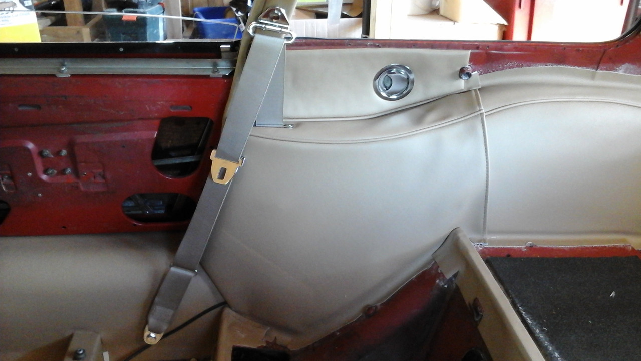

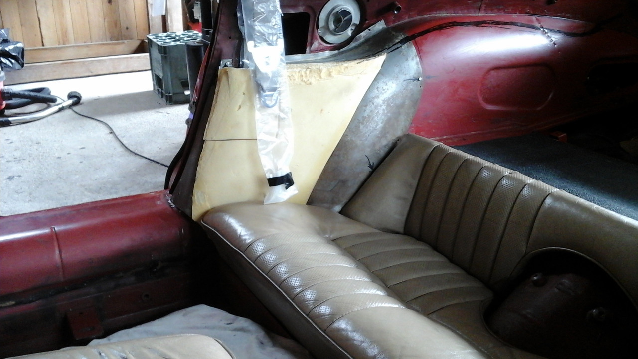

Hi Paul...what you describe sound about right...a home made looking metal panel covered in foam as mine here
Image and here completed .. note that i have split the wheelarch trim the join is where the rear seat fits so is hidden quite well its not easy making a neat job of the seatbelt entry/exit...if you need any help pm me... Steve

Post by mgcjag » Wed Oct 31, 2018 5:08 pm
This may help also

Steve, youre a hero, thats exactly what I was looking for. Im now glad I didnt throw anything out, as home-made as it looked! Youve also done exactly as I plan to on the seatbelt. Could I ask where you got the bezels from? Ive bought a pair of black plastic parts but chrome would look better. I imagine that whole area will be a fun job, particularly when that contact adhesive takes hold!

Hi Paul...i assume you mean the chrome part where the belt comes through....its called an escutcheon....so search for that..mine were from CMC they are about £40 each........you get the top chrome part and a bottom unchromed plate to fit under........you will have to alter the top of the metal panel to make it a bit wider to fit..Steve
