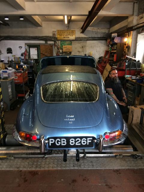

I’m just back from a rolling road session with Peter Burgess. My mate was on first with his modified MGB with a big valve head, Weber, cam etc, but it didn’t do quite as well as hoped. Mine on the other hand did great! Its done just over 1000 miles since a rebuild, has the ITG Maxogen & UE needles and a 123 distributor. It seemed to perform really well from the start with just some better fine tuning of the carbs required. One rich, one lean, one OK. Peter commented on how crisp and willing to rev it felt, when they can often feel a bit flat. It’s making peak torque at about 3250 and is flying at 4000! This equated to over 213 BHP at the wheels so closer to that mythical 265 than I was expecting! I was almost disappointed, expecting it not to be much better after the session but it really feels so much crisper and more eager now, despite the good start. It really wanted to go on the motorway heading home so I really had to apply some restraint! It’s the best money I’ve spent on the car so far! Enc some snapshots...
