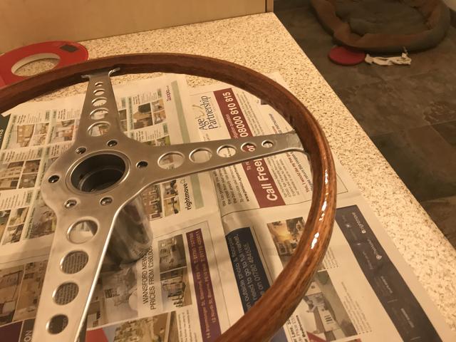

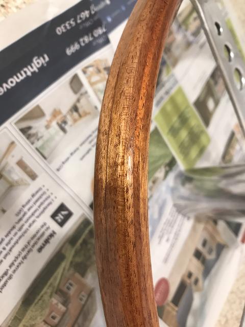

I had a later style rim for my 63 fhc from him.
Very Good quality and after light sanding with medium grade wire wool, 6 coats of teak oil followed by 4 coats of semi gloss lacquer, I’m very pleased.
They can be finished in any number of ways to suit you.
