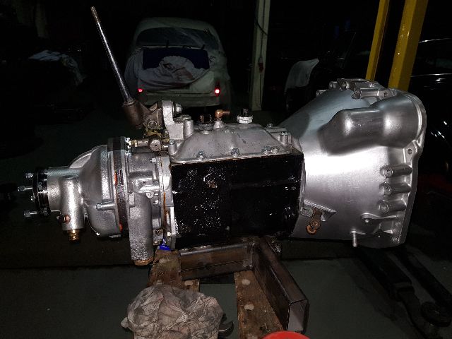

Hi Chris...A KJS gearbox is from a 2+2..as far as im aware you cant fit an overdrive unit to it....are you sure the top cover is not from a KJS (stamped) but the gearbox from another Jag(number spamped on case).....usually with these 4syncro/compact A o/d swaps into a 2+2 the prop does not need shortening....so im interested in your conversion...any photos?....Steve

Yes the KJS box came from a Series 2 2+2. The overdrive was added to that vehicle and then sold to me as a complete solution as they fitted a 5 speed Getrag.
Here is the unit built up including the overdrive.
We all thought the original prop would work but my car was auto so perhaps it is only the manual which is the correct length when the overdrive is fitted as my original auto prop did not work and the options from SNG specific for the 2+2 also did not go straight in.
I built a circuit for it with hidden button that puts it into overdrive on one press and out of overdrive on the second press. A change from fourth also drops the overdrive.
Its a neat solution.
