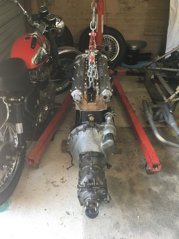

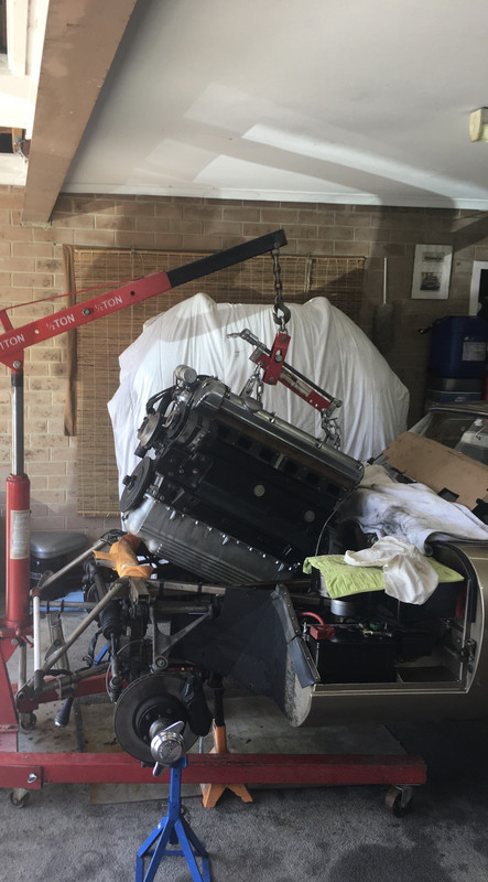

Post by peters3103 » Sun Nov 17, 2019 1:04 am
Glad to report engine is safely on the garage floor. A minor mishap when the engine hoist tipped forward so employed another hoist with longer legs that did the job. I’m having difficulty removing my Champion spark plug caps which haven’t been removed since I first fitted them. No matter how hard I pull them up they won’t release. Reluctant to use grips of any sort as I’m sure they’ll get damaged. Any experiences here?
