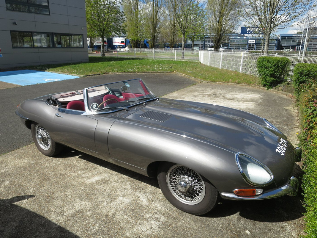

Post by Sarthe72 » Tue Nov 19, 2019 2:17 pm
You're probably - as always - right David, but what I love about this forum is that we are all E-type people and know our cars in depth. The contributions are on the money, not wishful thinking. Before I restored my car (for the second time) in 2013 she was Ford Glacier Blue (rather like Opalescent Silver Blue but a bit brighter), a colour I chose in 1987 for the first rebuild, and she then had chromes. I later changed them to painted because it was impossible to keep them clean with the car doing so many miles per annum, and the painteds are perfect I find. But you might prefer this photo of her then. Used for the Beeb's "The Car's the Star" in the mid 1990s.
Posts: 13163
#16 Re: Wheel sizes
Post by Heuer » Tue Nov 19, 2019 2:38 pm
Another option?
I would never have thought that combination would work, but wow what a statement!

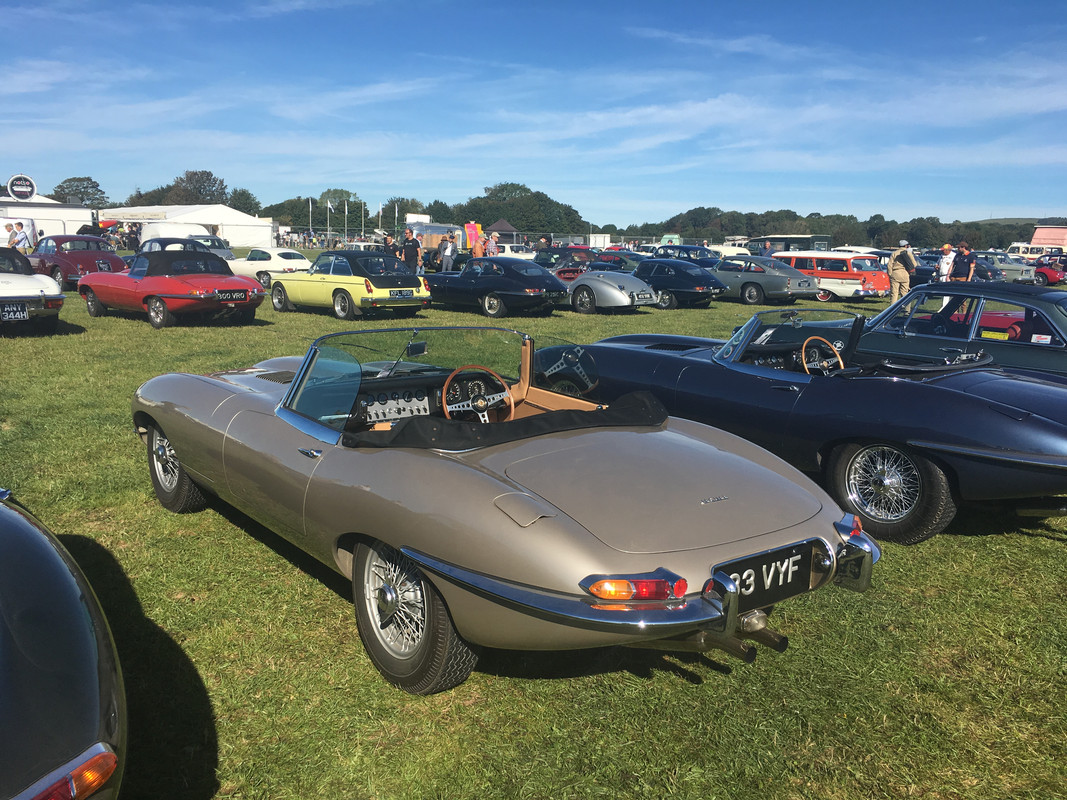

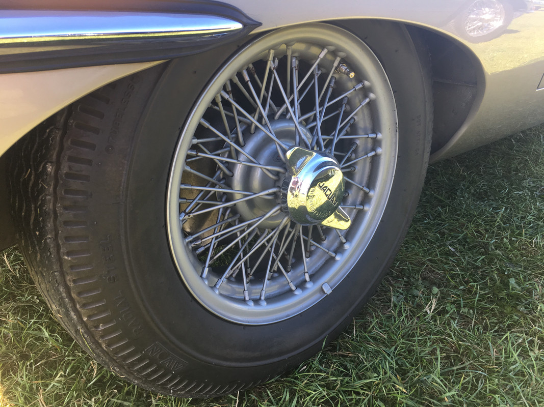

Post by peters3103 » Tue Nov 19, 2019 8:03 pm
My Golden Sand FHC has worn 3 different sets of chromes but I lean towards stoved aluminium now. I saw this OTS below in the Revival car park and thought it looked fab. If $$ weren’t a factor I’d have a alternative set of stoved aluminium wheels - 5 1/2” competition rears and 5” fronts shod with Dunlop R5’s. Just for show of course...
Actually the Avon’s on this car look pretty good.
