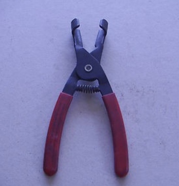

These might do the job if they’re not too wide to fit between bottom of cap and cylinder head. Could be ground down I suppose.
