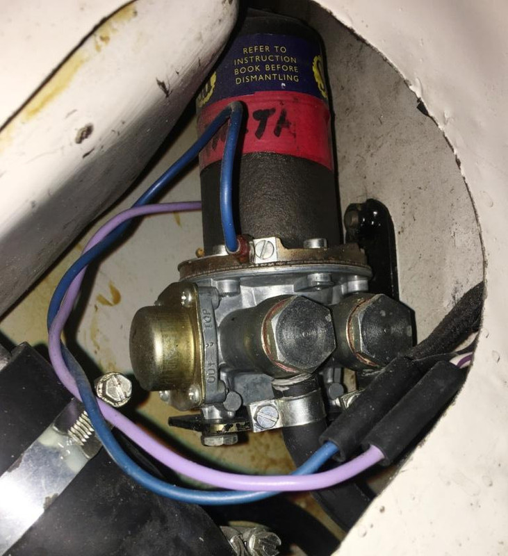

I am pretty sure the in tank fuel pumps are polarity sensitive. When a mechanic converted my 3.8 from positive to negative ground he neglected to reverse the leads on my fuel pump. The car made it half a block till the fuel bowl were dry and then started up and ran fine once I reversed the leads after a bit of head scratching.

The in tank pump is polarity sensitive so will need to have its wires swapped over at the joint block in the wheel well.

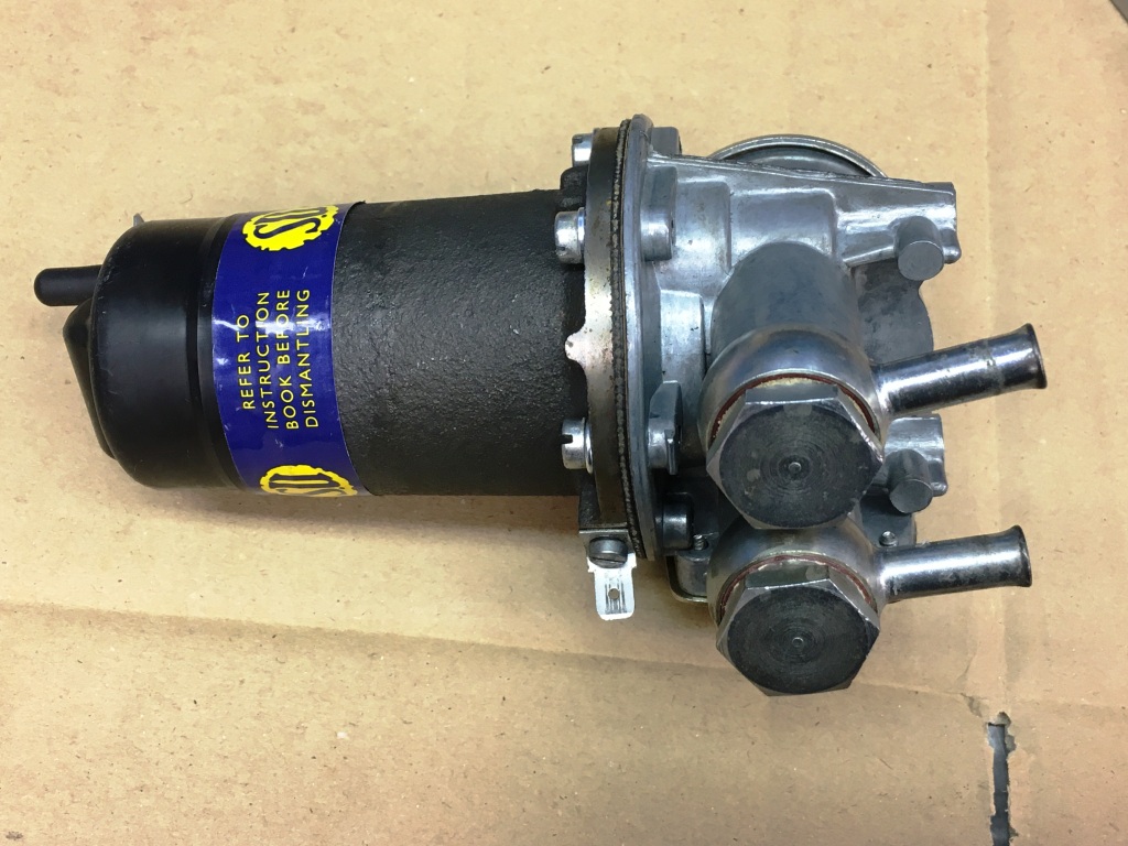

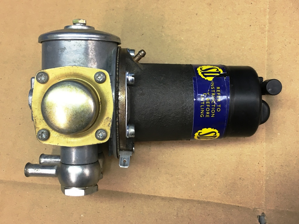

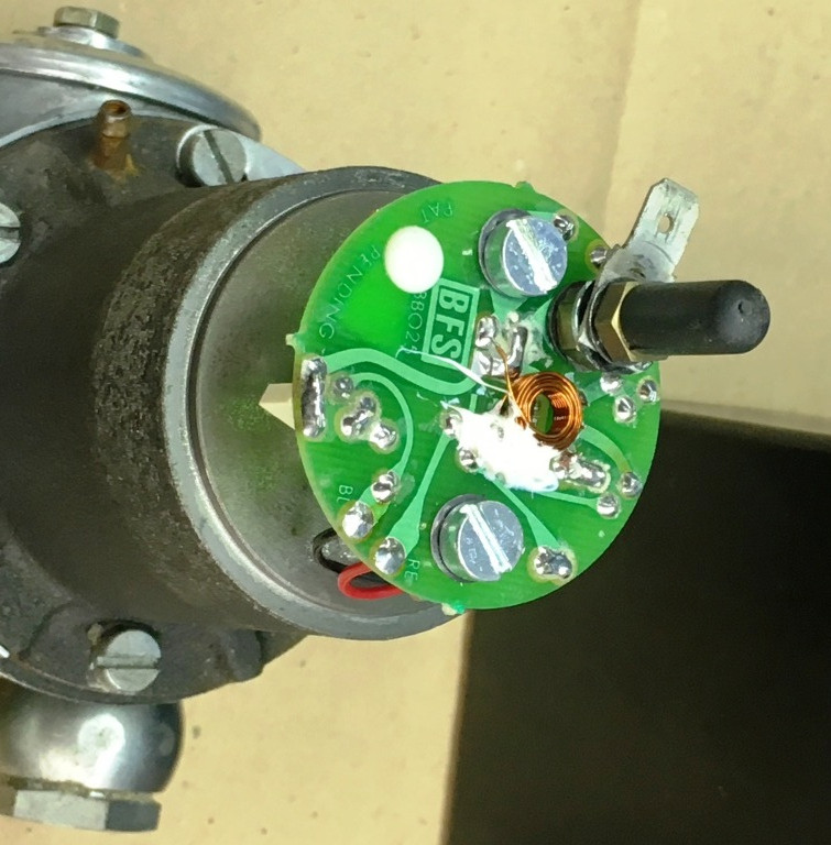

Mine is electronic SU from Burlen, out of tank.
Suspect the guts may need to be changed, and not a simple wire-swap, as they do list both -VE and +VE as different references.

Indeed, this type of pump can't just be flipped with the wiring, according to Burlen, so I'll have to buy a negative-earth one after all.
Anyone needing a perfect +ve earth electronic points pump, as a spare maybe, step this way.
