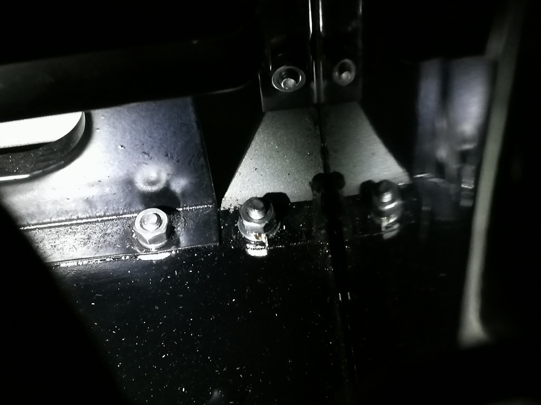

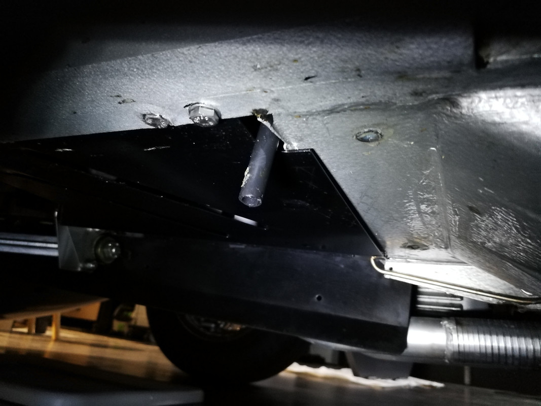

Can anyone tell me how the aluminium stone guard BD27427 is fitted?
At the sill side, is it fitted on top of the battery support, or is it sandwiched between the sill and the battery support?
At the back, does the edge sit under the floor or should it sit on the kick panel bottom edge?
Thanks,

Hi Paul
At the side, it should be sandwiched between the sill and the battery support. At the back it sits under the floor.
