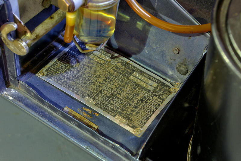

This photo is from a June 1961 body shell which has just been cleaned back to bare metal and only shows two holes.
and, just for reference I took a photo of the opposite side...
Clive

Generally, on 3.8 cars the holes in the left side are for the RB310/340 Control box and those on the right side are for the rivets securing the data plate . On 4.2 cars the control box is replaced by the 4tr alternator control

As Richard says, one of the holes is certainly for where the metal P clip for the wiring harness in the footwell attaches.

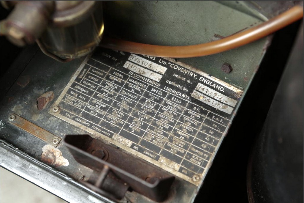

Post by Ian Howe » Wed Feb 05, 2020 7:07 pm
This is not definitive as there were IMHO considerable changes throughout early production.
875039. The two pop rivets (seen on early car and held a wire tag on the inside) have 'rusted’ away and the external 'wire' tag has been broken off. The external 'wire’ tags were only present for a shortish period. Note the position of the ‘P' clip changes depending on assembly - compared to the other cars shown.
Note also the triangular aluminium patch pop-riveted to cover the hole on the front of the A post - present about body numbers in the 30-60s (I think so don’t quote me please) until the rubber plugs were introduced.
875039 detail after strip down. From the bottom - front lower hole was a 3/16 bolt holding a 'P' clip, then the two holes with blanking plugs, the two close pop-rivets holding a wire tag inside and a solitary pop rivet next to the broken external wire tag.
875039. RB 310 side showing 'wire' tag and the rivets holding the wiring loom cover. Aluminium patch removed.
This LHD roaster is approximately 50 behind 875039 and has the hole at the rear of the panel.
This pre-production car has both holes but welded up!
Same car showing inside detail and wire tag.
