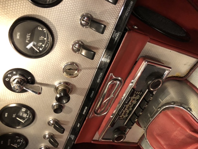

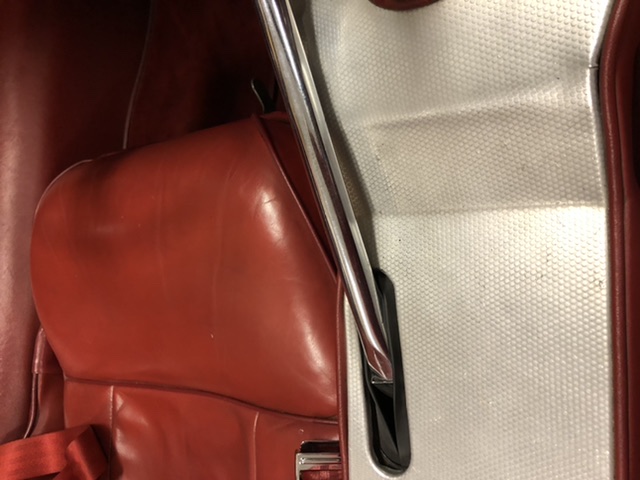

My 3,8 (881583) was built on March 22nd 1964, yet it has what looks like an original alu panelled interior. I have always assumed that a later US owner changed from black/leather to alu panels, but who knows...?
I prefer the early alu panels, and I find the cubby box in the way when switching gears.
What do the experts have to say?!?!

If it were the original dash/console/radio trim, it would be crosshatch, not polka dot - the same as I found under some of my leather trim. I suspect it was changed by a po from either leather or part leather/crosshatch And he wanted it all the same. As you can’t get cross hatch anymore (other than diy using Aston Martin sill covers) this is why it is all polka dot, like mine now is.

I have car 881743 and can confirm that your car should not have any aluminium panels. It should also have the cubby box/armrest on the centre console. These changes were introduced as per the following Jaguar Spares Bulletins:pmansson wrote: ↑Sat Jun 27, 2020 8:27 pmThis is interesting!
- August 1963: Bulletin P91. From LHD OTS Chassis No. 879761. Introduction of revised Gearbox/Propeller Shaft Tunnel Finisher (including central armrest)
- September 1963: Bulletin P95: From LHD OTS Chassis No. 879803. Introduction of revised Instrument Panel having a black-trimmed face.
- September 1963: Bulletin P97. From LHD OTS Chassis No. 879803. Modified Front Finisher Panel trimmed in Leather, having previously had an embossed Aluminium face.
I can see that your car also has the (useful) sun-visors (which were only introduced from the 4.2 cars). As such, it may be that a previous owner has trimmed the car to what they find aesthetically pleasing as opposed to what would have been fitted to the car at the point of production.

Good info, and as I suspected. But I am very pleased about the POs change as I prefer it to the later style. I find the cubby box in the way when changing gears, and I love the alu panels.
