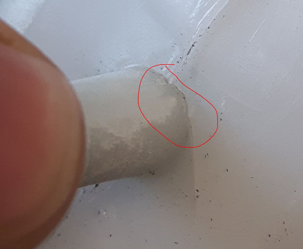

#4 Crack in reservoir bottle
Post by danxke » Tue Jul 28, 2020 8:29 am
Hello,
well, I guess the leak is in the bottom of the bottle:
This is the "re-enforced" type with the metal pipe in the nipple (C36607 CLUTCH RES.BOTTLE SQ), also from the usual, 2 years old.
Had anybody else this issue with new bottles?
greetings
Dan
Posts: 6305
#5 Re: New Clutch slave cylinder: losing fluid overnight?
Post by mgcjag » Tue Jul 28, 2020 8:45 am
Yes not uncommon..lots here and on other posts viewtopic.php?f=4&t=14329&hilit=Fluid+bottle
