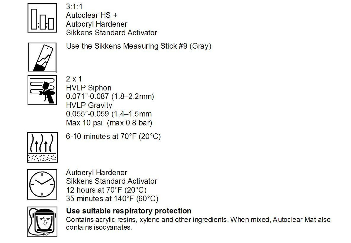

Following is an extract from a Sikkens data sheet; so as to compare oranges with oranges regarding your ex sikkens paint trouble-shooter. You can look at the data sheets from any number of Automotive 2K paint manufacturers and the information is very similar. They all give comparative time of curing at an easily achieved ambient temp and a force curing temperature. None, or very few at best, state that forced curing with heat is mandatory.

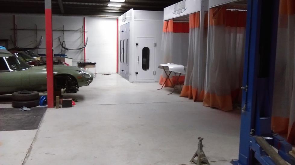

Typically, prep bays are not dust proof. Their main purpose is to help stop contamination of the remainder of the workshop. They have curtains to assist in containing the dust created therein and an exhaust system that creates a lower pressure compared to the surrounding area. Accordingly, as well as containment, further contamination is sucked into these areas from the surrounding environment. Therefore, if you want a non-slip, textured paint finish, paint it in a Prep Booth and not a proper Spray Booth.
The main purpose of a proper spray booth is to provide a dust free environment and a draft that sucks the over-spray away from the painted surface. The best system is a Full Down Draft, where the over-spray is drawn towards the floor and not over the previously painted surfaces.
The following picture shows the two prep bays and the spray booth of my shop.

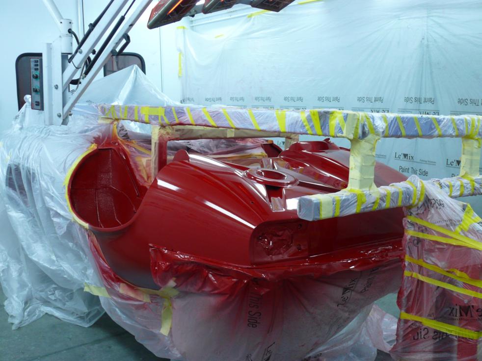

Following is a picture of a first finish operation of an S3 E Type. Its rather cold in Ballarat at the moment and the heat lamp is only to get it touch dry. In warm weather, no external heat would be used.
