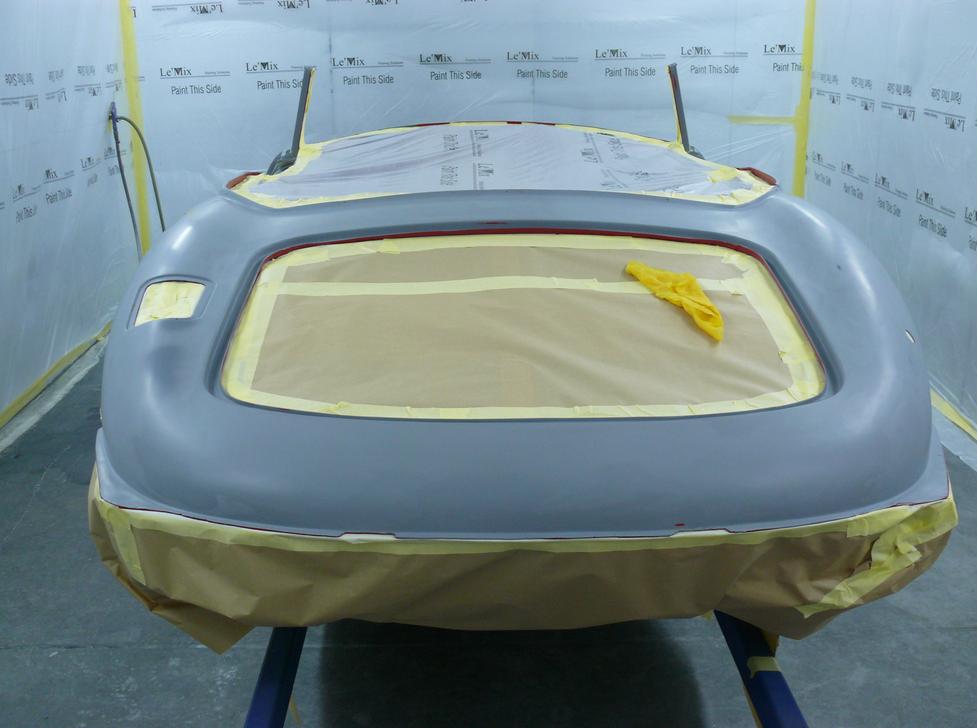

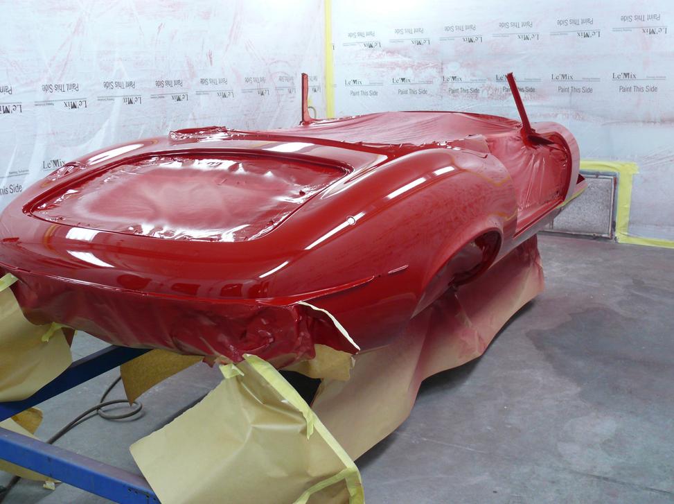

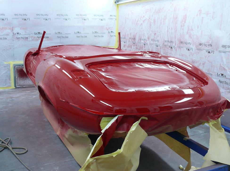

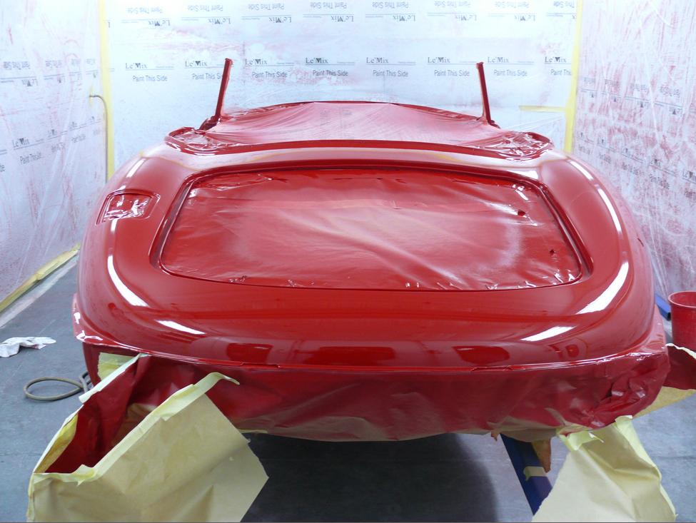

#29 Re: New Paint
Hello Geoff,
The following picture is of the Boot Floor and Lower Quarter Panels, shown just painted in my earlier Post, now just after cutting and polishing prior to setting the body right way up to prep for paint.
I paint E Types in this sequence, panels below the rear Bumper Bars, Cut and Polish whilst its upside down, then Right Side Up and paint the Top Surfaces, because we get a perfect finish on the underside of the Boot Floor that is equal to what you would expect for the Top Surfaces. When the top surfaces are painted, I do a very small blend where the Rear Wheel Arch and Rear B/Bar Tip almost meet and as the paint is all from the same mix, a perfect blend is achieved.

#30 Re: New Paint
Hello Bill,
Now you've explained this I should imagine it gives you easier/better control of the work and finish than trying to do too large an area at a time.
It is always fascinating and informative to learn how the professionals tackle their work.
Another classic example of the friendly and helpful nature of this forum.
#31 Re: New Paint
Hello Geoff,
Large areas aren't the issue, it's that the paint finished surface of an E Type's Boot Floor reaches so far under the car that painting that and the Top Surfaces of the body with the car right way up is, in my opinion, is inconvenient and not conducive to a consistent, excellent finish. Cutting and polishing that area whilst its still upside down allows getting the body off of the rotisserie and onto the wheels of the dolly for the remainder of operations. Cutting and polishing the underside of the Boot Floor later on, with the body right way up is a real chore.

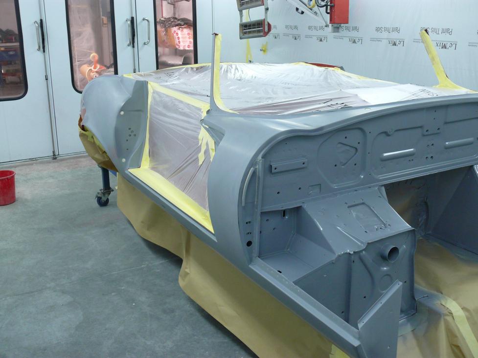

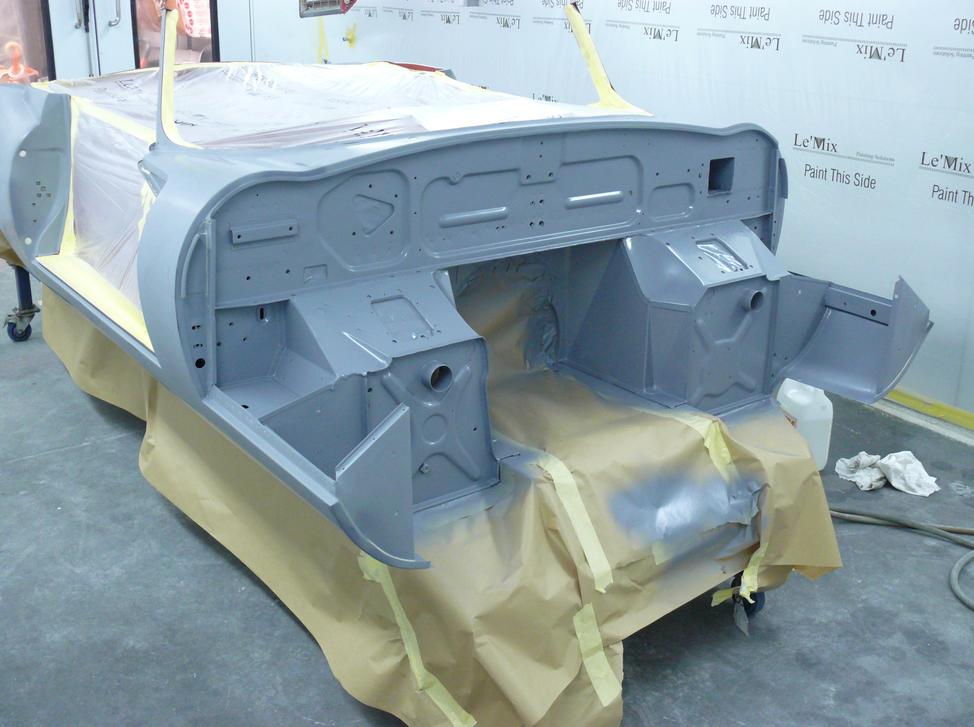

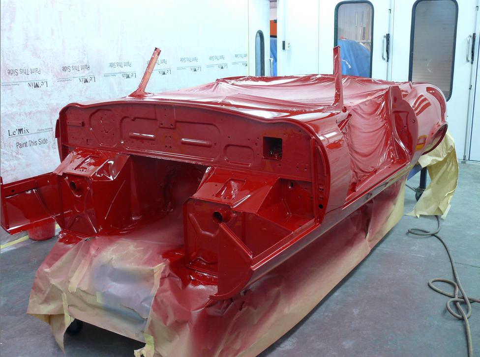

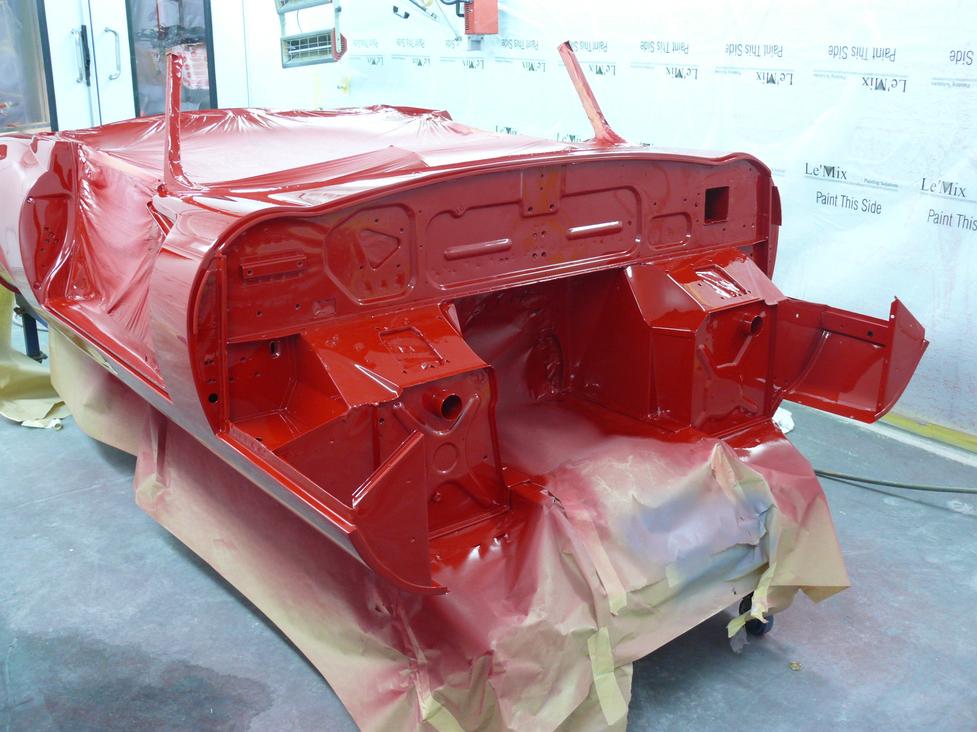

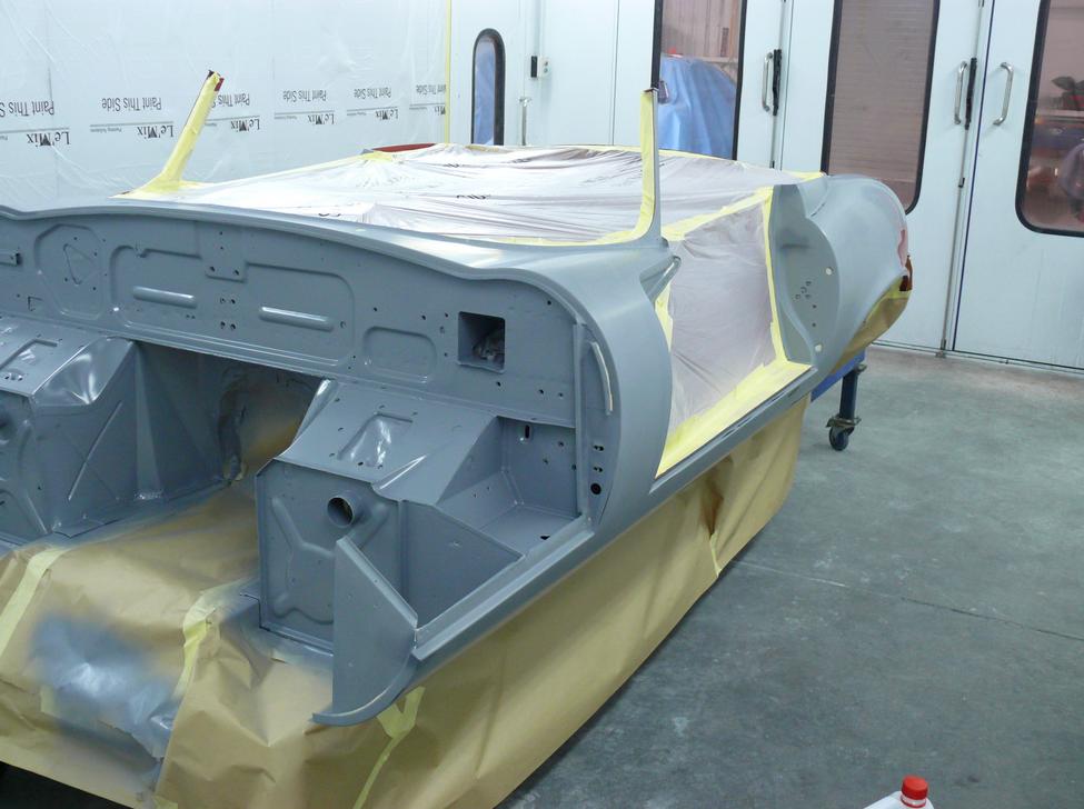

Hello All,
Here are pictures of the car featured in earlier Posts when the underside of the boot floor was painted.
A non-sanding, wet on wet primer was used on the bulkhead; you can see that it has quite a shine compared to normal sanding primer. The result of its use was excellent.
The masking pulled away at the rear of the tub is from when the small blend of the previously painted underside was carried out where the rear B/Bar comes close to the wheel arch.

#36 Re: New Paint
Bill, can you explain a bit more about this wet on wet primer, please?
Why did you use it only on the bulkhead? As an experiment, and if so will you use it all over the next car? Do you apply it to bare metal or is there another primer underneath?
I’m finding your comments on paint very useful and will appreciate learning more from you.
Many thanks
PS, my online search didn’t give a decent description of wet on wet, hence my questions
Many thanks
#37 Re: New Paint
Hello Geoff,
There are two ways to have subsequent paint systems adhere;
1. by chemical link
and
2. Keying the surface; what I call the Ploughed Field effect.
If you look at a painted surface under high magnification, after it’s been sanded, it looks like a ploughed field; generally, this is necessary to give a subsequent paint system something to grip onto.
When applying Top Coat, you’re actually using wet on wet technique. Subsequent coats are applied when the previous has flashed off, but long before it’s cured. In this way, a chemical link is achieved between the coats of paint. If for some reason you had to come back and apply further coats a week later, you would have to sand the paint surface to create the Ploughed Field affect.
The wet on wet primer I used was designed to speed up the repainting process in the general repair industry, where it can be applied directly to OEM e-Coated panels and then Top Coats applied without sanding the primer, resulting in a huge time saving.
This primer lays down flat and smooth, just like a well applied Top Coat and therefore, presents a good surface for subsequent Top Coats onto which to be applied. It’s allowed to flash off for 12 minutes, after which Top Coats can be applied to achieve a chemical link with the primer. A window of up to 48 hours exists where a Top Coat system can be applied without sanding and achieve the chemical link.
My motivation for using this primer was born out of a previous job where a Series 2 2+2, converted to a LWB Roadster, was finished in a slightly pearlescent paint. Notwithstanding that the substrate was properly prepared and final sanded with P800 grade abrasive, the visual affect was darkish streaks in the metallic that coincided with the sanding marks. My reasoning was to use a non sanding primer to provide a scratch free surface onto which to apply the pearlescent/metallic base coat. This worked out perfectly.
In the case of the car pictured in my previous Post, the bulkhead had been initially primed with a Black, epoxy primer and for uniformity of coverage; I wanted a consistent coloured substrate. I didn’t savor the prospect of having to sand the bulkhead again and so, on the back of the success with the slightly pearlescent paint exercise, decided to use the non sanding primer. One coat of the non sanding primer was applied, resulting in what you see in the pictures in the previous Post and a perfect surface, after it had flashed off, onto which to apply the Red Base Coat.
There is no necessity to use a non sanding primer over the whole of a car that has been primed and prepared correctly. The main reason is to cover varying colours of substrate to present a uniform coloured base. Some paint for repair work has a particular coloured primer specified. Therefore, on a solid colour, I don’t think I’d use it over the whole car, but on a metallic paint respray, I think yes.
The non sanding primer I used, De Beer 8-746, is not recommended on areas of metal exceeding 10 cm². Further, as only one coat should be applied, there is no scope for filling coarse file marks in metal after completing a repair.
1. by chemical link
and
