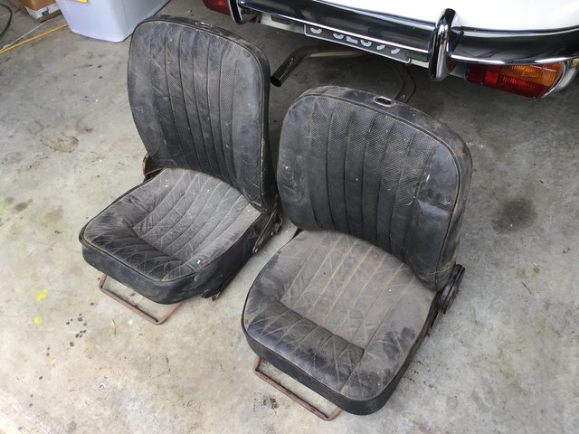

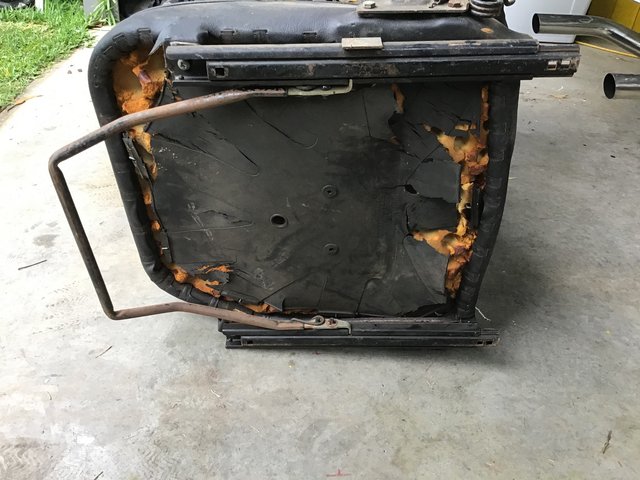

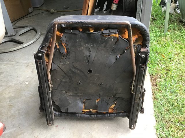

I’ve been going through all the parts supplied with the new project. From the beginning I was aware the the original 3.8 buckets were missing, but a pair of later 4.2 seats were supplied.(along with new foams, and full covers) The rail mechanism was quite different to my S2 so I’m fairly sure the seats are actually from a S1 XJ6.
I’d like to use these seats as all the necessary upholstery has come with the car. Does anyone know if the correct runners are available ?
Any other options ?

Hi Andrew, those seats look like series 3 E Type to me.
Derek

Hi, that makes sense. The old chap was pretty sure they were E Type....I hadn’t thought S3. Obviously the floor is different and there is no crossmember in the way. Still wondering if there is some way of making these work?

Repro 3.8 seat runners are available - Barretts

That’s good to know. Not available through other suppliers I noticed. Series 1 set would be best and I may need to modify the bases to suit. All good fun. Cheers. Alan.
