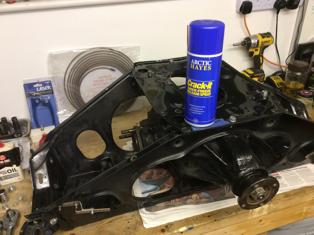

This is the stuff I use - Crack-it Shock-Freeze Release Spray. Better than using heat and the freeze action breaks the corrosion seal, plus it contains a penetrating oil as it freezes the components down to - 50 degrees C.
Great stuff at £7.45 from Screwfix and other suppliers.

Also doing a bit of work on my rear axle at the moment.

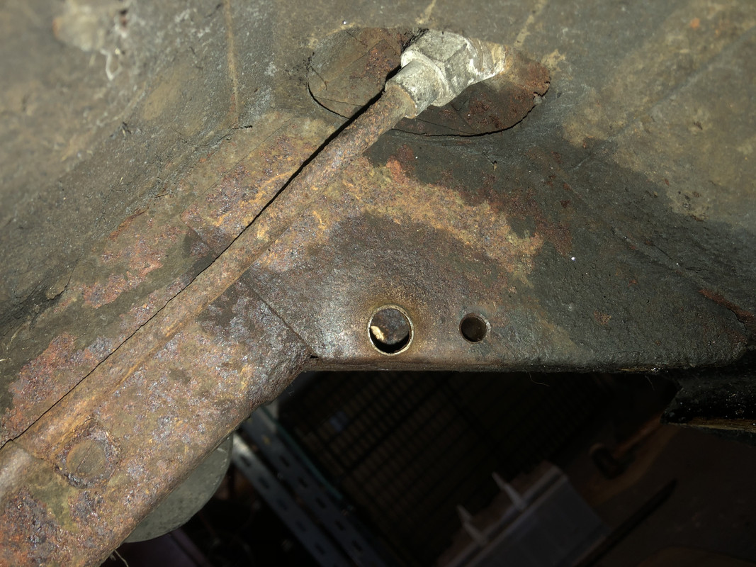

Thanks for the tip Dave - will try to get some tomorrow - just hope I can get it to penetrate into the chassis arm.
As you can see from the photo access is limited and if the bolt is rusted to the guide tube over its full length then it may take several applications along with pressure with the G clamp and probably some persuasion with the lump hammer!

Many thanks to all who have offered their help - I have today cut off the head of the bolt and removed the mounting bracket. This allowed me to drive the bolt and tube out together leaving the oversized hole shown in the photo. I now have to find a way to get a sleeve back into the chassis leg and close up the hole
