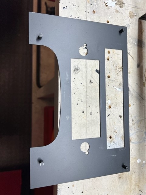

- how does the metal faceplate attach to the frame? It has four pins (photo below) which engage into four holes in the frame, but I can't work out what holds them in place

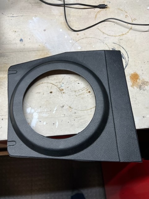

- regarding the black trim panels that go over the sides where the speakers are (photo below), does the front edge of these fold over the front of the console frame, or do I trim them off at the front edge?

You need these.
https://www.sngbarratt.com/English/#/UK ... 201752115)
Available on eBay - certainly in the uk
On the second point, I folded mine over. Used a heat gun on low setting to make it easy to bend
