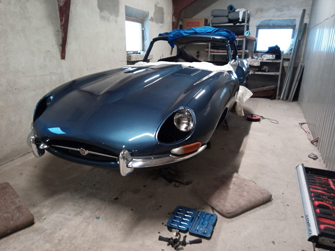

As an E-Type rookie I've learned that this car definitely has to be assembled in a certain sequence, or you have to go back and redo stuff. I haven't messed up big time like forgetting the propshaft, so far so good I think. And a few books talk about it. But now I've gotten so far, I "only" need to do interior, doors (3), glass, chrome etc., I'm not sure what the best sequence is.

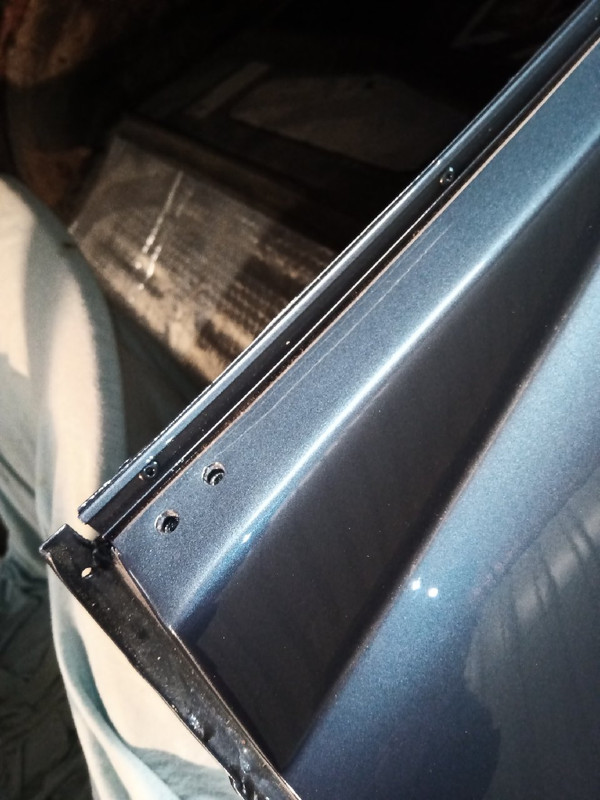

Currently I'm preparing stuff like the cantrails to give to my upholsterer when BAS items arrive. But then I started to wonder about how they are attached. Long story short, should they be upholstered and installed before the seal retaining channel kit that I already installed (before painting, picture)? If yes, I have to drill out rivets, install cantrails with rivets from the outside and then reinstall retaining channel??
I'd like to hear the forum's view on the sequence for the latter parts. All my local E-Type friends have OTS' or much later models so their help is not sufficient. My thoughts were, and please correct me:
1. Do all the interior beige roof
2. When all things controlled inside the dash works, install dash top
3. Windscreen
4. Rear door including opening mechanism
5. Glass in rear door
6. Then most of the red stuff
7. All rubber on the sides
8. Rear side windows (lights as you call them?)
9. Doors, naked
10. Fill doors with handle, chrome frame, glass and opening mechanisms while on the car
So, any concerns about that sequence? I don't mind hard work, once! Hate to redo stuff

You may find that you have rivetted the seal retaining channel using all the holes provided, which is what my body guy did. It's not a total loss because all you need to do is drill the rivets out of the holes that are supposed to be used for fixing the cantrail crash pads (using small No.4 screws).
Install the headliner, including the cantrail side curtains (pig of a job) BEFORE you fit the cantrail crash pads. Once you've fitted the crash pads you can install the door seals in the channels.
Also, do not fit the dash top until the crash pads are in and the grab handle fitted. Then fit the windscreen. It all makes things a bit easier.
