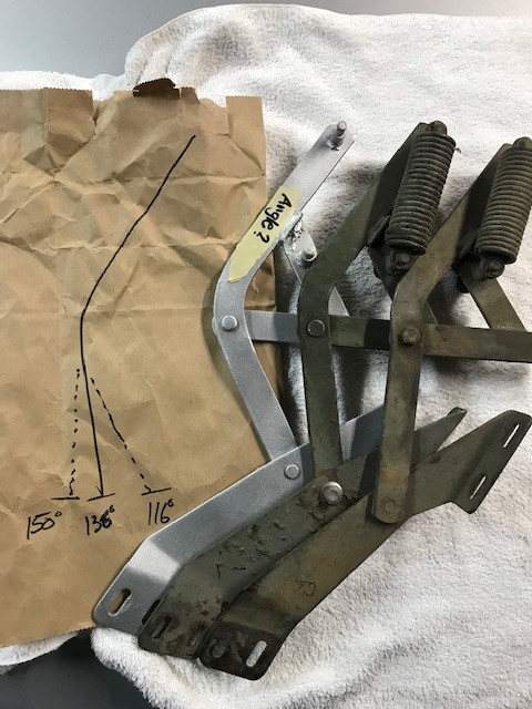

Beginning to sort out the different balance link assemblys. I have a collection and my friend found he had two (one each right and left) that have a different angle to the curve. I looked at mine and I found three different angles of about 115 deg, 136 deg and 150 deg. Recently one forum member posted his bumper would strike the ground. If the different angle links are installed the bonnet opens different amounts. The part numbers I have found so far are BD-20014, BD-20015 and BD-20016, BD-20017. There may be more as I have not looked through all the parts documents. The Martin Robey links have an angle of about 136degrees.
A photo of the bonnet link (either side and the year with model of your car) taken at 90 degrees will assist in figuring this out. I should be able to get close to the degree reading from the photo.
Thanks for your interest and assistance.

Geoff Green
Posts: 141
#8 Re: Bonnet Balance Link Assembly
Post by Geoff Green » Thu Dec 20, 2018 12:49 am
Thanks for the photo Paul.
Yours are aftermarket and about 136 degrees. This is the angle in the main, longest section where the gentle curve is.

Geoff Green
Posts: 141
#10 Re: Bonnet Balance Link Assembly
Post by Geoff Green » Sat Dec 22, 2018 10:00 pm
Paul, meant to say yours are the same as aftermarket at 136 degrees. Most of the ones I have are also 136 degrees. As seen in the photo the long link with the bend is the angle I am measuring. Oddly two cars have had different angles with one 136 degree link which my friend noticed when he tried to install both and found one would not bolt up like the other after installing the bonnet. I compared the ones I have and found three different angles. Most are 136 degrees.

#11 Re: Bonnet Balance Link Assembly
Post by paulsco » Sat Dec 22, 2018 10:25 pm
Interesting; I was not aware there were different angled links.
However, blowing up your photo, it looks to me like the one on the far right is bent where the bolt is substituted for the rivet.
