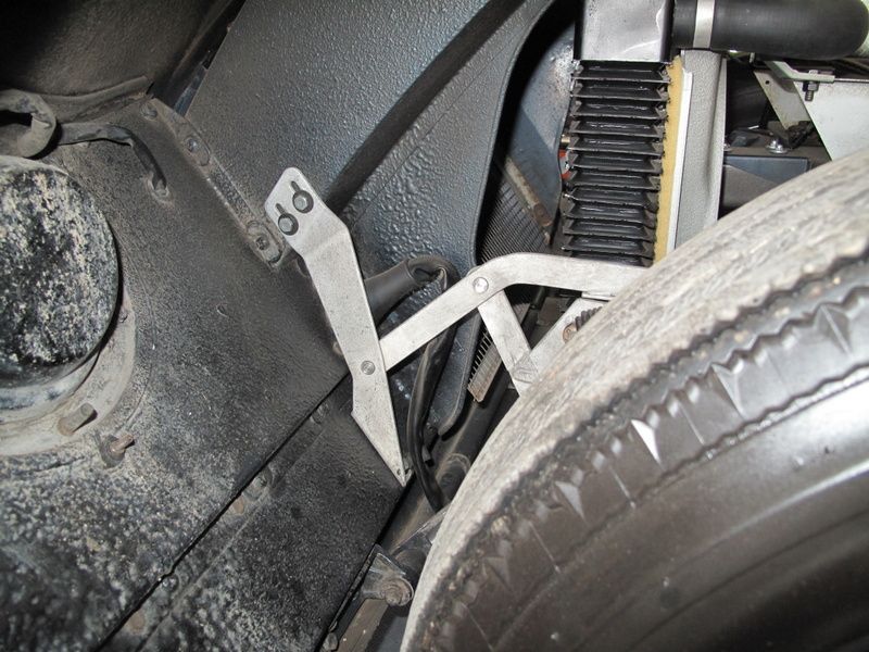

Perhaps I am missing something here but Radtec, NAR and Fosseway say this style of radiator was only fitted up until October 1961 but as far as I am aware the Marston aluminium radiator was fitted up until almost the end of 3.8 production. Glausager says "It is speculated that later 3.8 cars may have had a copper (brass) radiator as did the 4.2 model but it has not proved possible to verify this."

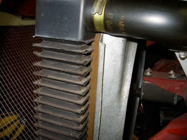

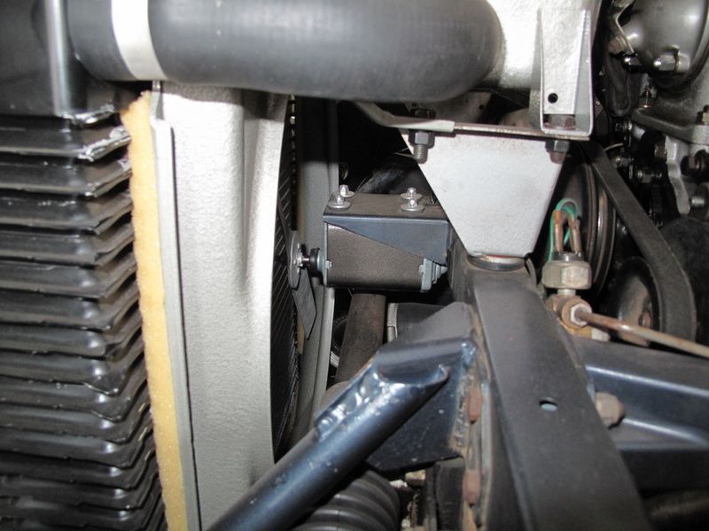

This is a 1964 un-restored 3.8 OTS #881640 with 20,102 miles from our 'Factory Fit' thread:
This is a 1963 FHC #887530 with 27,000 miles on the clock and has not been restored from our 'Factory Fit' thread:

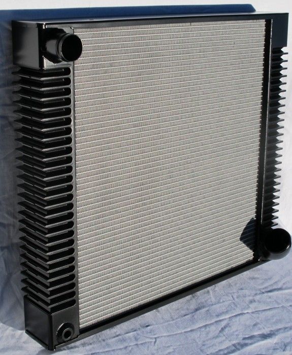

If anyone is thinking of buying one of these (and I have to say they are very good - I am using the original fan and it rarely comes on even in heavy traffic) you need to specify the black sides because a) that is the correct colour and b) it would be almost impossible to do a good job with a rattle can. You can buy a reproduction Marston plate from Coolcat Corp to complete the ensemble.

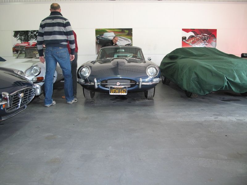

This is the iconic view from the front of the 3.8 which the 4.2 does not have - the exposed aluminium radiator core:

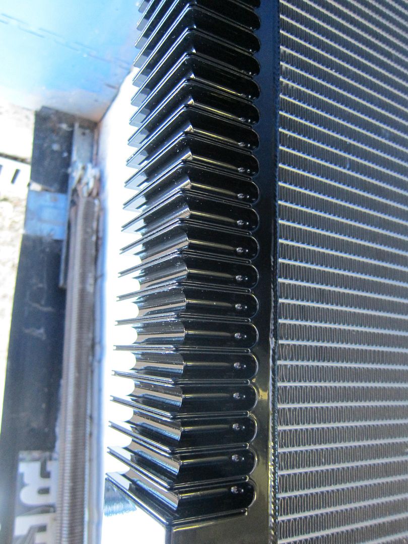

Had a closer look at the Fosseway 'Marston' radiator and it does seem to be a better copy than the Radtec. Specifically the machining of the fins is closer to the original and the top and bottom plates correctly wrap around the side tanks and do not show a weld as the Radtec does:
The Radtec:
That weld:

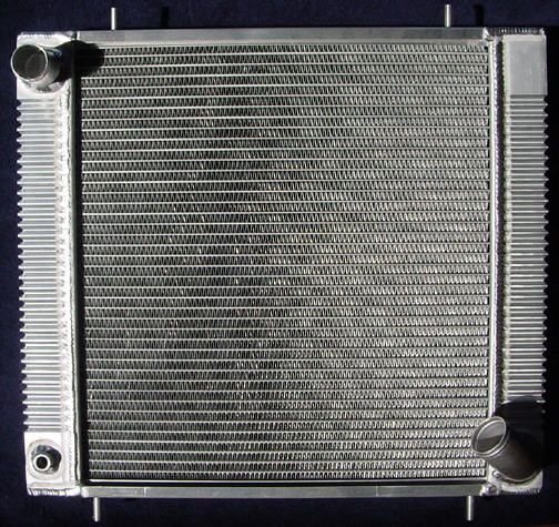

The Fosseway, when I wanted one, was on three month backlog and £1,500 delivered. I found this from Welsh in the USA for $800 and had it two days later by FedEx
ImageAlloy Rad 1 by Tony Brown, on Flickr
This was a few years back and the radiator is fine. I use a CoolCat fan with it.
