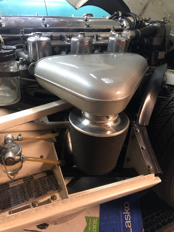

Completed my install of the ITG filter. Slight shimming out of the filter neck with aluminum tape. Next size up would have required the plenum neck to be sanded away as the OD on the neck is only 102mm and the 99 has an OD of 102mm leaving nothing. This is an early plenum that is two piece with the flared neck that slips into the plenum sleeve, so I guess the neck is smaller than the later plenums. Anyway that's how it is and the J60/93C with it's 96mm OD worked well. Used a stainless hose clamp around the plenum neck to provide some strength for the screws and put 3 screws through to lock the filter in place. Very straight forward.
Thanks for all the research and recommendations.

Update-test drive went very well. Runs great, maybe slightly louder but good, seems to start faster-like immediately and shuts down cleanly with smooth acceleration. Maybe it's psychological but jeeze, seems to run better!
Thanks again.
