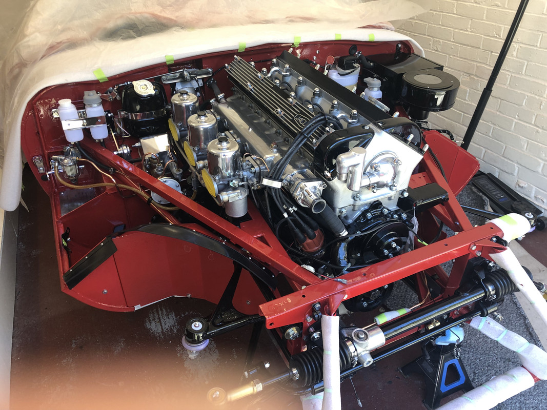

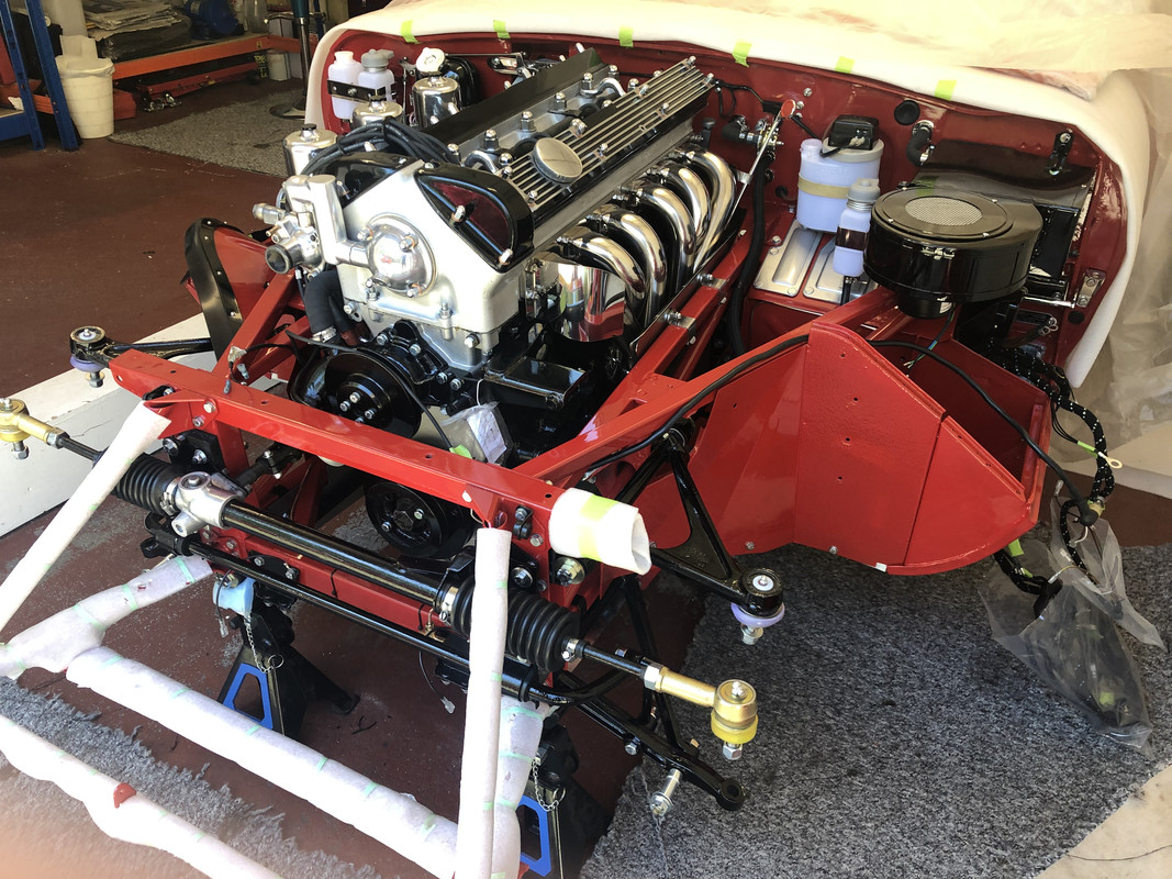

Post by mach2andy » Thu May 23, 2019 4:21 pm
Hi Ash
These are the belts that I ended up with. I got the alt belt right first time, but had to try 3 different sizes of W/P belt before I got it right! I had to shim the alternator slightly forward to get it's pulley properly lined up with the W/P pulley.
