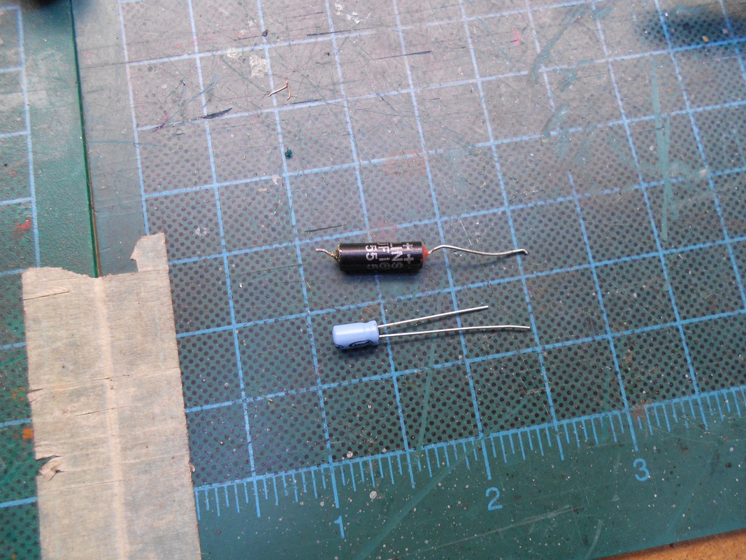

If you take it apart you will find an electrolytic capacitor on the small circuit board. Replace the cap. This fixed mine.

look for this black capacitor and replace it.
I am trying to find my notes on the value I used. it was close to the original, a simple job to solder in a new one

The original was 2.5uf. The modern day equivalent will be 2.2uf. Use a tantalum capacitor rated at 25 volts if you can get one and remember to keep the polarity the same way as the original.
