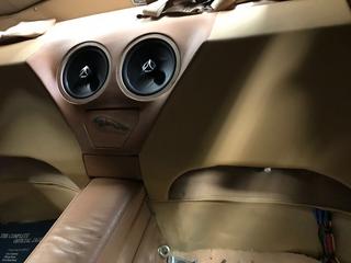

You will never get a decent sound with speakers installed in the radio console and definitely no bass. The rear of the cones are acting against each other, in effect cancelling each other out. High frequencies will suffer less but low frequencies require long throw of the cones and your opposing speakers act like shock absorbers.
Suggest you move the speakers to the footwells and add tweeters at the base of the windscreen. Jaguar went to the trouble of making cutouts for speakers so you may as well use them. More info in these threads:

Maybe something like this?
Here is the link on JL:
https://forums.jag-lovers.com/t/best-lo ... ers/366940
Ralph

#8 Re: 1970 Series 2 OTS - Subwoofer
Post by ndinsdale » Thu Sep 06, 2018 3:33 pm
spot on Ralph. Thats what im looking for :)
is there anymore info on how to do that or who did it?

But back on topic - the MX5 'Tombstone' seats have the sub woofer in the base of the seat, so you may want to consider locating it under one or both seats. However your current setup is flawed and no amount of sticking plaster is going to give you a satisfactory result or beat the laws of acoustics. Bite the bullet and do the job properly with footwell speakers and tweeters. Drop in and see Angus at Moss Jaguar, I am sure he will give you a quick demo of what you can achieve with a well thought out installation. The photo Ralph posted is going to involve you permanently modifying the rear bulkhead and the sound will still be poor because of the resonance in the boot space. You will need to put an acoustic chamber around the speakers which will take most of the boot space.
You could fit one by making a box housing to fit behind the seats but you will lose precious cargo space.

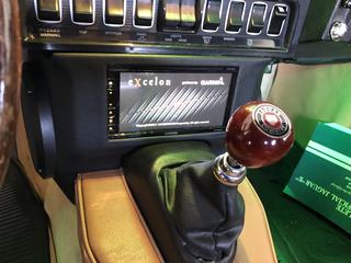

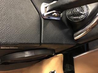

There is lots of room for mids in the footwell and I found a great place for tweeters.
And you can squeeze in a double din

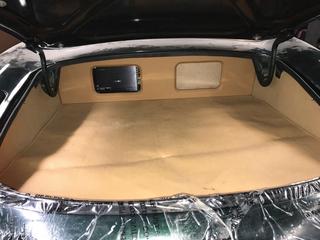

Box for the subs 2x 8 Inch and 2 x 6 inch mids with charging ports
Amp in the back
