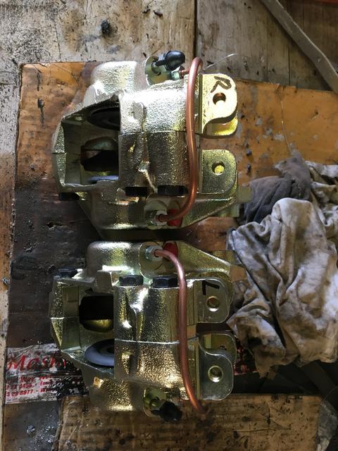

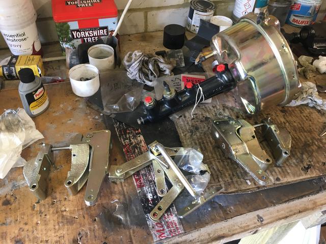

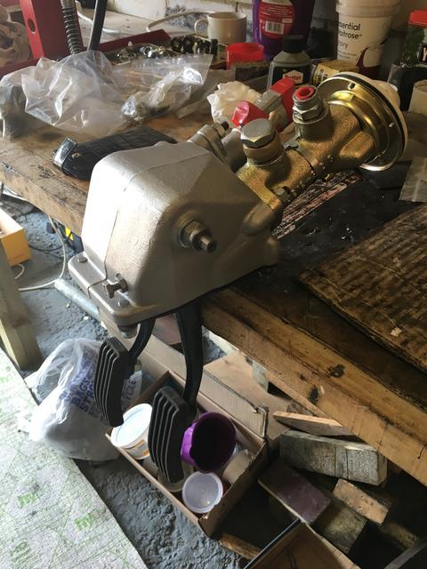

#8 Re: Front brake caliper thoughts
Post by mach2andy » Thu Sep 27, 2018 6:32 pm
Another thumbs up for Pastparts. They refurbished my whole braking system last year. Beautiful professional work, nice people to deal with & not expensive.
