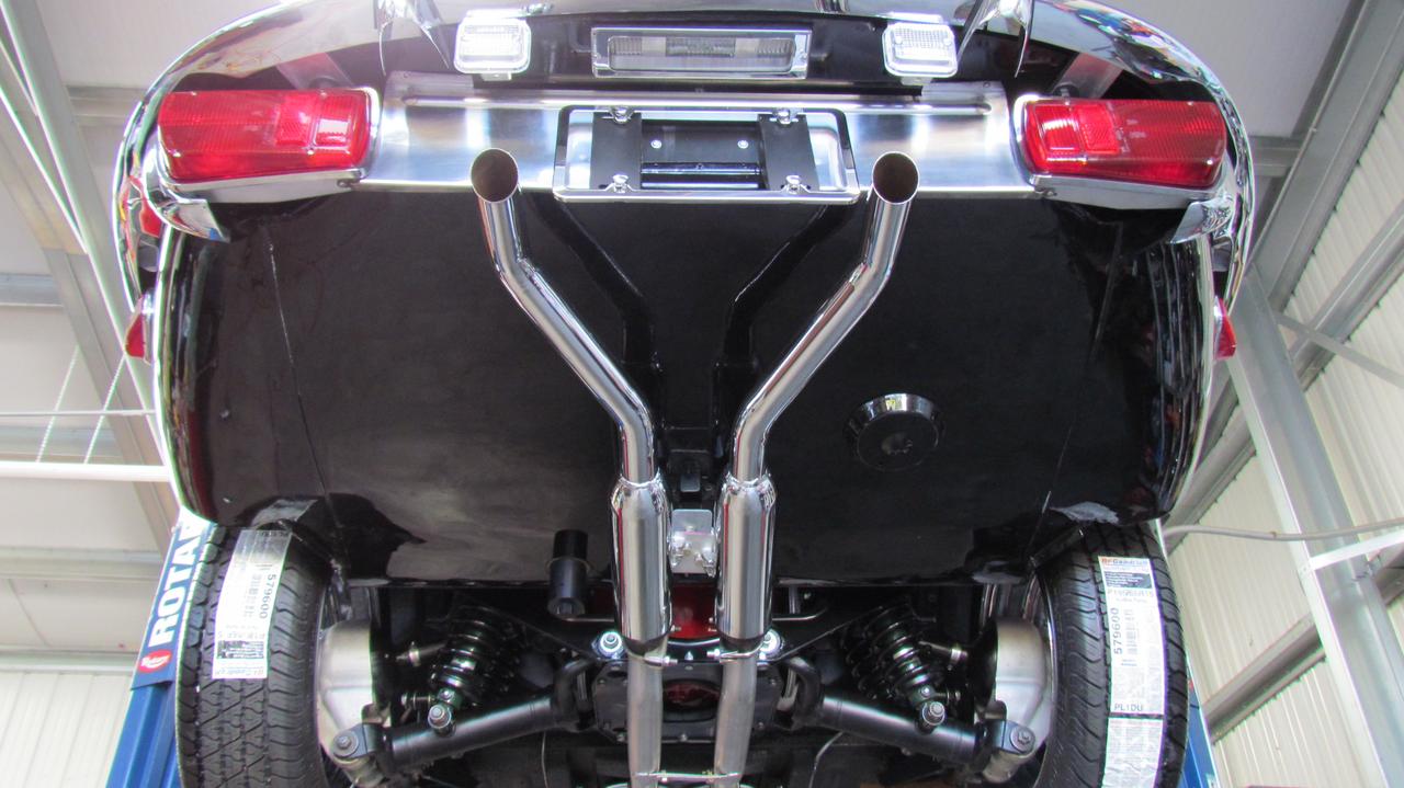

I wanted to ask about the gap under the rear taillights that you can see in picture 4.
It’s hard to find other pics of E-types from that angle but general consensus from people I’ve asked is that these gaps should not be visible. Is this an improperly adjusted bumper issue?

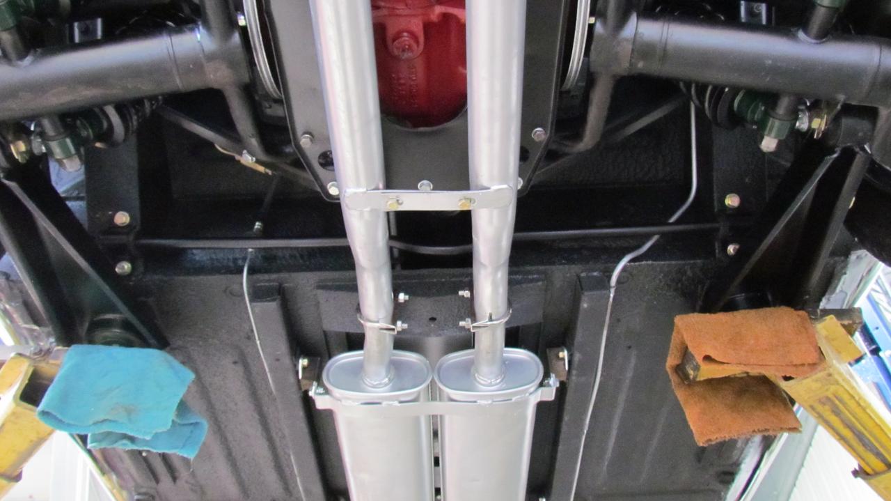

Minor point but image 6 looking at the sump and exhaust pipes I see two pipe clamps with the nuts and hence the u clamp stud ends sticking down. Bound to catch on a road hump. Turn them 90 degrees so the studs don't point down :bigrin:
Thanks!!
Hard to say with a picture taken from that angle, seems likely a gap is bound to show.
More important would be a direct rear view. From there on mine, I can see all the light chrome rim at the outside edge and it slowly gets less visible toward the centre of the car.

Are you not missing the side chrome caps that surround the outer ends of the rear lights?
It may just be the angle of the photograph so forgive me if I am being dim.

Your's looks like it's correct. here's mine
Ash
In fact I'm not, but I had to go out in the garage to check :scratchheadyellow:
That picture was taken before they were installed. Also I now have a rectangular (oblong) number plate and S1 tail pipes. I think it looks better :bigrin:
