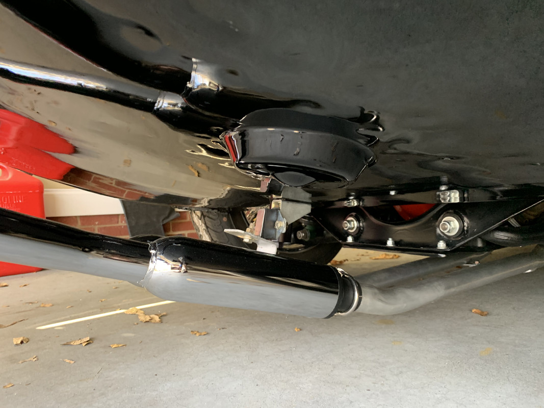

Hello all. My exhaust is low as can go...it will scrape with 2 people in the car. I’m worried this mount must not be the right one. How does this look compared to yours? Thank you!

My S1 cars do not have the second L shaped bracket between the mount and the exhaust crosspiece.

thats not right, look at SNG online for the correct parts assembly.
you need part 18 in this picture, not that crazy L or U shaped thing below the hanger.
C18975

Thanks much all. Diagram is super helpful.
