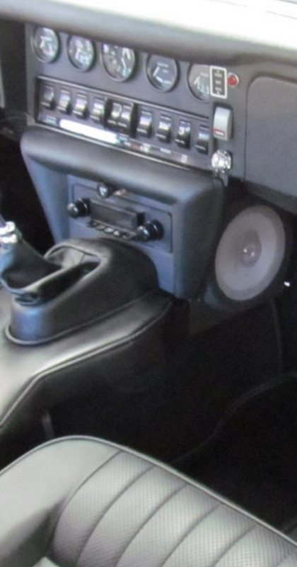

I need to look behind the gauges and to do that I need to remove the radio console. It seems to not budge so I presume there is a retaining bolt somewhere?

It is held by two nuts ( often dome headed ) near the upper forward extremity of the side panels, and/or in your case it looks as though there may also be one on each side at the lower forward area. Having removed the nuts, it is necessary to splay the side panels to clear the studs which the nuts attach to , and you can then move the console rearwards and upwards to clear the gear lever surround

Hi Anthony.....the panel with the guages should pivot down.....two knurled plastic headed screws top corners of the panel.....however if the radio console is fitted incorrectly it restricts the panel pivoting down...then as Christopher described above but it may not need removing..just loosen it a bit so the guage panel can swing down ..Steve
