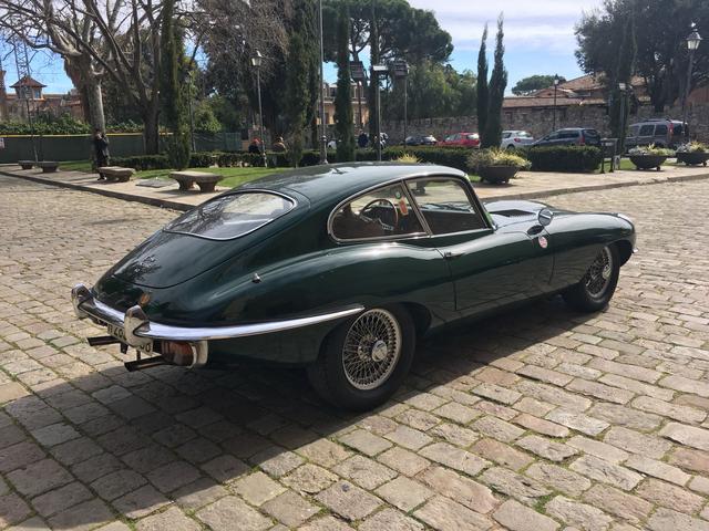

Post by politeperson » Mon Feb 25, 2019 9:17 pm
Where to start?
Post some pictures on the forum!

#6 Re: New car, Where to start?
Post by Classic » Mon Feb 25, 2019 10:19 pm
You are absolutely right firts thing is to poste pictures and also enjoy the car for a while before “improving it” if needed

Post by politeperson » Tue Feb 26, 2019 8:27 am
Well it looks great, so if it aint broke dont fix it. You will need to check it thoroughly though.
