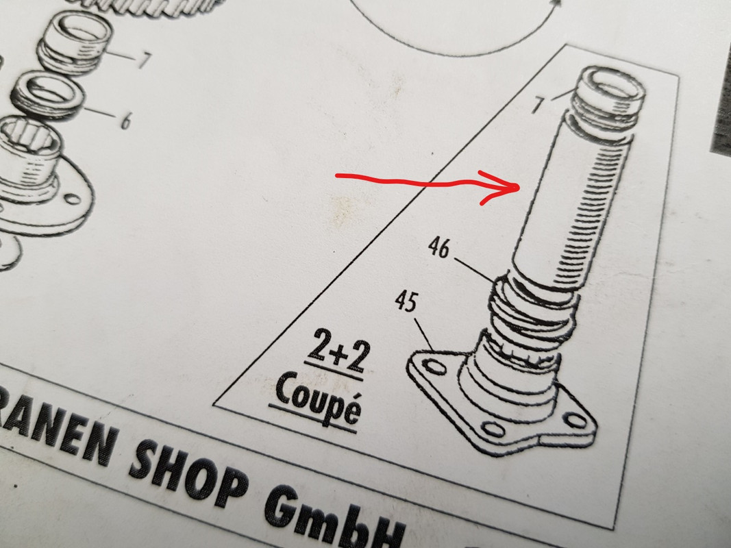

Hi, need help. After hearing strange noise I ended up with dismantled gearbox.
Bearings have to be replaced but also a distance tube C23336 which is not made any more.
I will make new one but as this one is worn out I need exact measures for it. Thanks. :helpsos:

The length is 4.156" (4 and 5/32 inches).
If the Distance Tube is worn, the clamping force applied by the Companion Flange nut must have reduced to the point where the Oil Pump Drive, Speedo Drive Gear and Distance Tube have been slipping against each other. This is a common fault, as friction alone, brought about by the clamping of these components by the Companion Flange nut, is all that drives the Oil Pump Drive and Speedo Drive Gear.
The following pictures are of the two sides of the correct, original rear bearing. You will note that one side has practically no radius between the face and bore of the inner race. This side of the bearing faces towards the rear and is the face that the Oil Pump Drive makes contact with. This bearing is no longer available, with the available replacement having a relatively large radius between both faces and bore of the inner race (similar to the larger radius shown in the second picture). The result is that the Oil Pump Drive only makes contact with the face of the bearing via a circular band of approximately 0.020" (0.5mm).
Although friction is largely independent of surface area, this small band contact compacts the face of the Oil Pump drive fairly quickly and the clamping force applied by the Companion Flange Nut is diminished. From that point, failure of the clamping force is exponential as the components are able to spin against each other.
Regards,
Bill

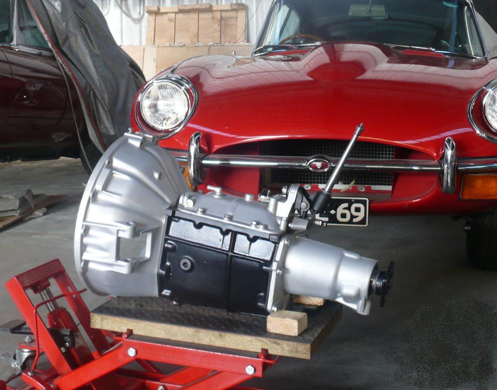

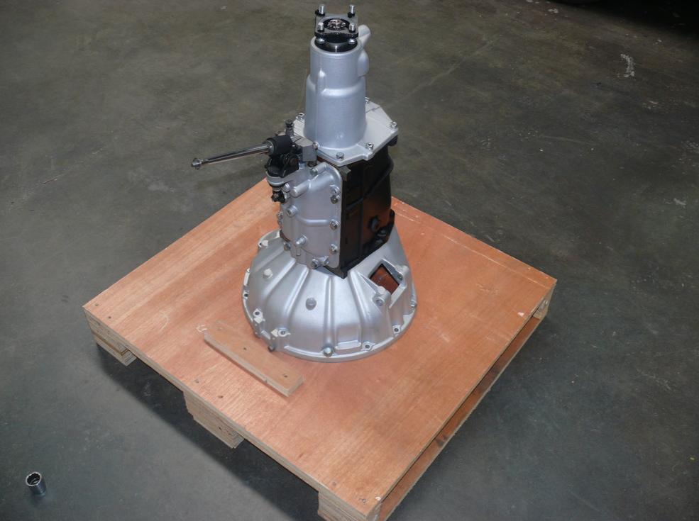

You won't get the proper bearing; they are not available. I recondition many early Jag gearboxes and make a modification to the bearing to obtain that important contact between Oil Pump Drive and Rear Bearing inner race face. Following are pictures of a finished gearbox being made ready to ship.
Find out the origin of the bearing you're getting. If its Chinese, don't waste your time with it.
Regards,
Bill
