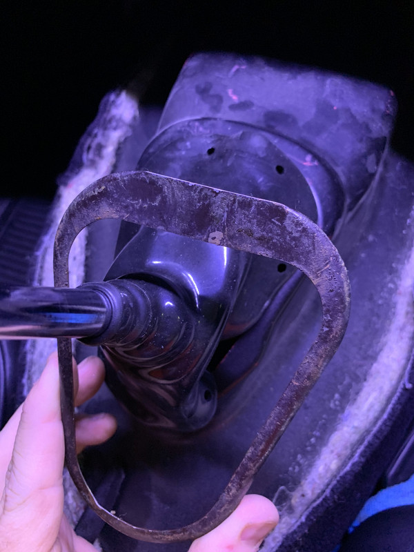

Hello all. Thank you as always for the help here. I had posted before about the fact that I always arrive at my destinations in my FHC smelling like a spark plug. I finally realized that a big part of the problem is that I had no rubber boot under the leather shifter cover and the leather was leaking air. I have procured a rubber boot but it seems that it will be difficult to install it.
Am I going to have to lift the center console to do this correctly? Remove the radio console too? That makes me very sad.
Can you tell me what the metal ring is that you see me moving at the start of this video? The ring doesn’t seem to have screw holes so I don’t see how it could relate to the rubber boot.

Hi Anthony....you need to remove the center console.....the rubber gaiter sits on top of the metal cover over the gearbox and held in place by tbe metal retainer.....Steve

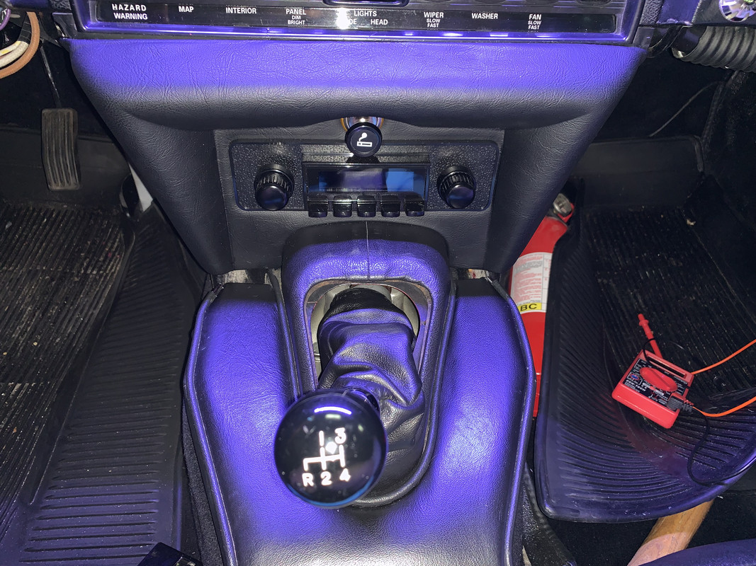

Thanks all. Before I dig into taking the car apart, I wanted to ask about this gap I have between the radio console and the center console. I presume that something isn’t the right part or that perhaps a PO modified or cut the center console. I’m betting it was to allow an easier install of the stereo console.
In any event, I don’t see a good way to fix it now. I don’t see how I could slide the center console forward because of the raised shifter area.
Thanks Anthony

Hi Anthony....this area can be challenging to sort out....first does your instrument panel drop down fully if you undo the two knurled screws in each top corner.......quite often the radio panel sits too high to allow it to drop down....see how that looks first..also your gear lever surround looks like it may have been retrimmed in leather..if so it makes it slightly larger.......you will just have to move it all about for the best if not perfect fit....Steve

So I got the center console out of the way. I’m still a bit confused about the rubber boot. The holes in the rubber boot line up with the holes in the metal just fine. I just assume there should be a plate that holds the rubber down. I have this metal ring but I assume this metal ring is for the leather boot not the rubber one since it doesn’t have screw holes in it.

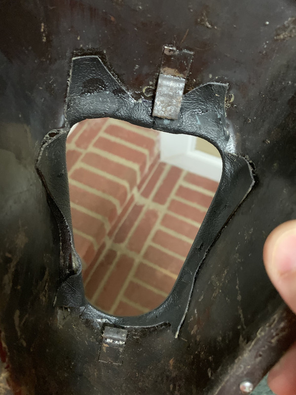

The ring you have should be glued into the base of the leather boot. Then it will neatly be retained under the 2 spring clips that can be seen on the underside of the console in your second picture. The boot should not be just glued in like you currently have it. As you correctly state, there is another similar looking ring to hold the rubber down with screws. I believe these will be readily available from the usual suppliers.

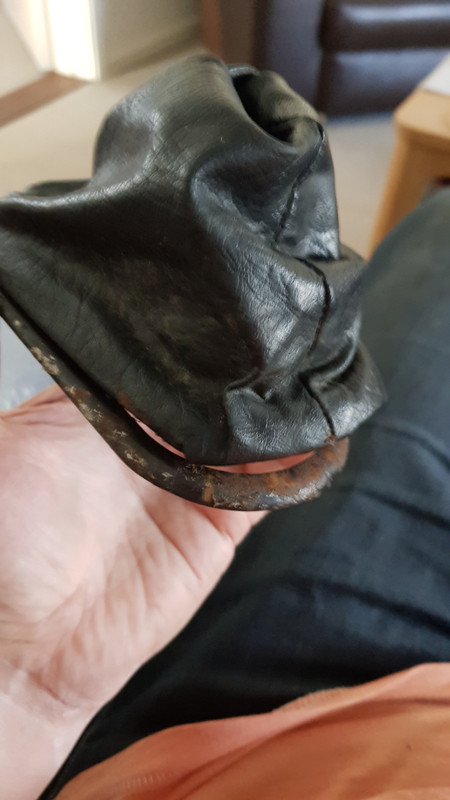

The ring you have should be glued into the base of the leather boot. Then it will neatly be retained under the 2 spring clips that can be seen on the underside of the console in your second picture. The boot should not be just glued in like you currently have it. As you correctly state, there is another similar looking ring to hold the rubber down with screws. I believe these will be readily available from the usual suppliers. Attached photo is of my leather boot which I replaced recently. I had just peeled the leather off the ring.
