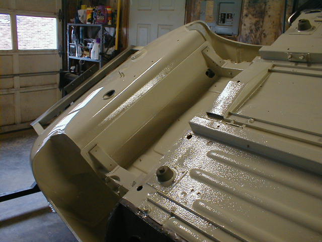

I took my car to metal, also. Sprayed on 2 part epoxy zinc chromate primer (Variprime). Seam sealed all the joints, and then sprayed 3M "rock guard" onto the primer/sealer, and then painted with single stage Old English White (tougher paint than base/clear). Same for the wheel wells and the wheel wells under the bonnet. NO black or undercoating. Gets a little dirty looking after driving awhile, but cleans up well and I don't think it will be subject to rust. I'm in the USA and after a 6 year restoration I try not to drive in the rain (I have other cars for that). Being in the UK you will definitely have a different experience with weather and road conditions.

Thanks Jeff, that is massively useful. Great that you chose the same colour as me! There is no way this car will ever be used in all weathers again after this investment, and I like the idea of having a much clearer view of the underside and being able to spot any problems etc. I've no idea what you are suggesting about UK weather however...

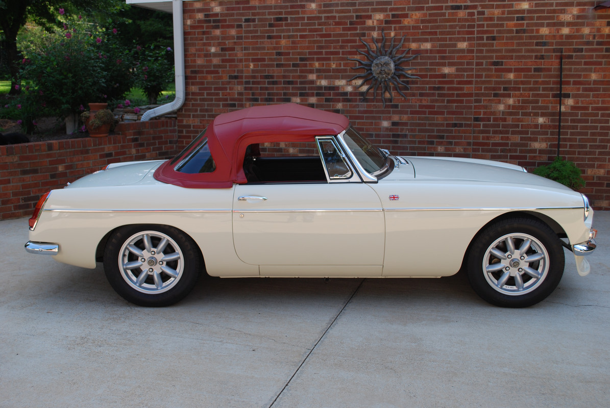

Yours being an OTS, I would stay with the OEW instead of the "resale" red. If you want some red, the hood would be nice in that color.
Here is picture of my MGB in that combo.

Lovely MG. I wasn't serious about the red! I have a picture of myself and my brother sat in the Jag when I was 13 in 1977. I'm not planning on changing what I've known and loved for so long.
