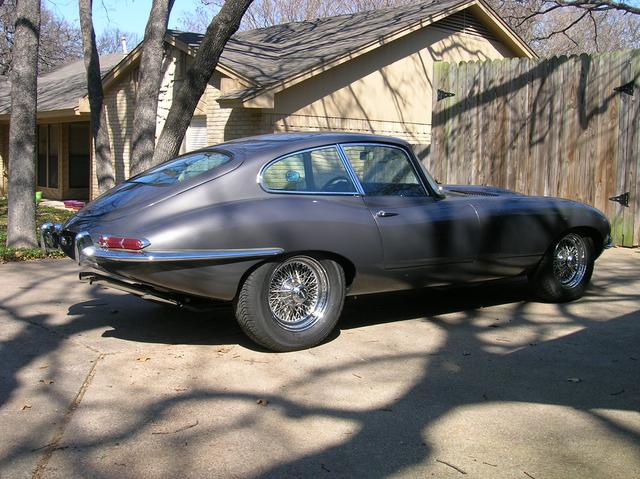

There are many archived threads regarding wheel/tire size, both on this site and on Jag-Lovers. Fitment depends on wheel offset. The link below is one of them. There are some linked photos of the 6.5" center laced MWS wheel in one of the posts in the thread.
While a 6.5" center laced MWS wheel apparently works with a 215/65 tire, my experience is that the maximum tire size with a 6 inch center laced Dayton (different offset) is that tire size is limited to 205/70 (see attached photo). A factory offset bead laced wheel would have accommodated greater width (with bump stops removed).
The J-L thread link: https://forums.jag-lovers.com/t/e-type- ... ls/66724/5
Photo of 6" center laced Dayton with 205/70 rear tire:
Eric
