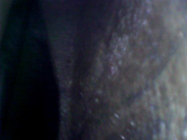

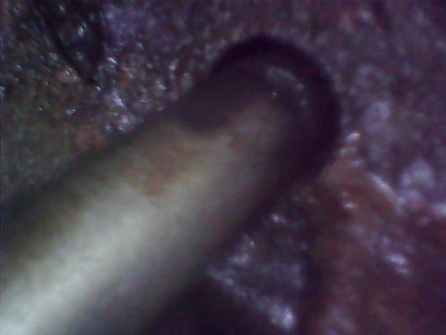

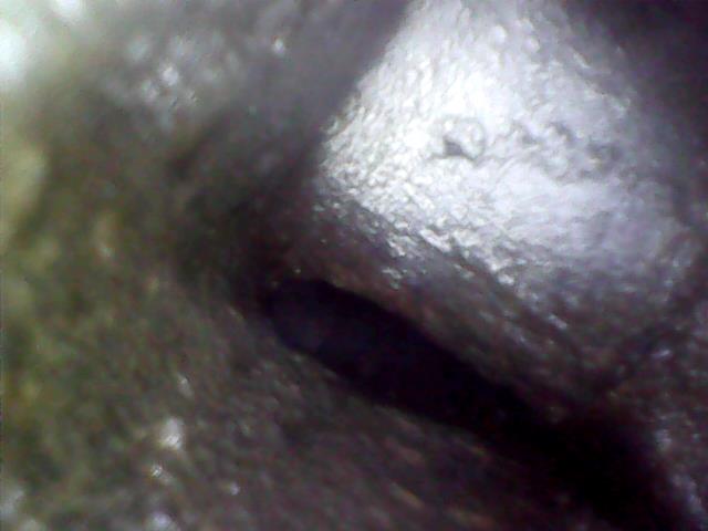

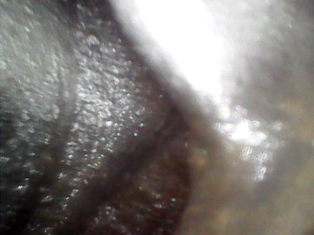

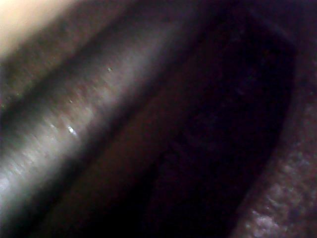

As per Steve's suggestion I tried peering into the block through the water pump inlet/outlet but couldn't see much due the viewing angle. I hit upon the idea of using one of them there endoscope camera thingy's. Got a cheap one from Amazon, connected it to the PC and shoved it in... :shock:
I managed to slide in a full 14 inches without protest on the exhaust side and snapped the first 4 images (below)...
I then inserted it in via the thermostat housing and down the first inlet manifold water gallery about 8 inches and took the next 3 pics...
The images aren't great quality and I'm not sure eactly what/where I've got pics of, the base of the head studs I think, but there's deffo no blockages or crud in the those areas :thumbsup:
I also checked the fans and while they're both turning in the same and correct direction one is much stronger/faster than the other so I will need to repair or replace that one.
Based on the above I'm 80% happy there's isn't excessive sludge in the block and will put it back together with the new water pumo and see how we go.

It looks very nice and clean to me, I must say.
