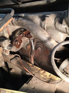

I got the sump off today and was surprised that it came off quite easily with a 1 foot breaker bar. It was completely full of rust and other debris. Should there be some kind of filter on the pick up tube because there was nothing there ? Also, does anyone have a picture of what I think is the throttle return spring and what it connects to ? It looks like the top half rusted off and broke off in the middle. There is a small hole on the linkage above the bracket that the bottom part is attached to but I want to make sure before I start it up some time later this week after sitting for 6 years ! Thanks !

#11 Re: Fuel tank sump removal
Tom,
Here is a picture of the spring on the carburetor that I'm talking about. The one one the bulkhead is fine. I got one from the local hardware store that is most similar to the broken one until I can find out for sure which one from Barratts is the correct one as they have a few on there. So is it connected correctly ?

#12 Re: Fuel tank sump removal
I think that’s the secondary throttle return spring, C23853.

#13 Re: Fuel tank sump removal
Yes, Tom. Even though I don't know much about these cars at the moment, that would make sense considering the primary spring is on the bulkhead. Thanks again for your help !

#14 Re: Fuel tank sump removal
I mean it’s the spring for the secondary throttle butterflies.

#15 Re: Fuel tank sump removal
Thanks, Tom. I looked up that number on Barratts and it said the part is "unavailable". I will have to call them tomorrow and see it they have a replacement.
