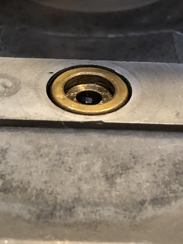

Today I took a new look on the carbs.
Adjusted the needles with a tool ( do not know the name but it has metal strips in different thickness ) to be exactly 0.05 mm above the piston.
Jet at about 65 thou (1.6mm) down from the bridge.
I checked the float bowl level and here comes the strange thing, all float needles closed at 11mm but still one carburettor had a higher fuel level and actually floated the jet on the rear carb having the level at the same height as the bridge.
I suppose the fuel level should be at the same in the jet for every carb so I had to change the float bowl height by using 12-13 mm instead of recommended 11mm. Now all jets and fuel level looks like the one in the picture instead of having the fuel level at the same height as the bridge.
After the fine adjustment it runs much better on idle, the oscillating is almost gone, definitely an improvement. I took a small test drive and still some lack of power when accelerating maybe a little stronger but less noise at least. The eventual difference in needle heigh, fuel level in the jet and the jet height seems to cause the oscillating.
Hopefully I can re-tune the carburettors now since the start point is better than before.
