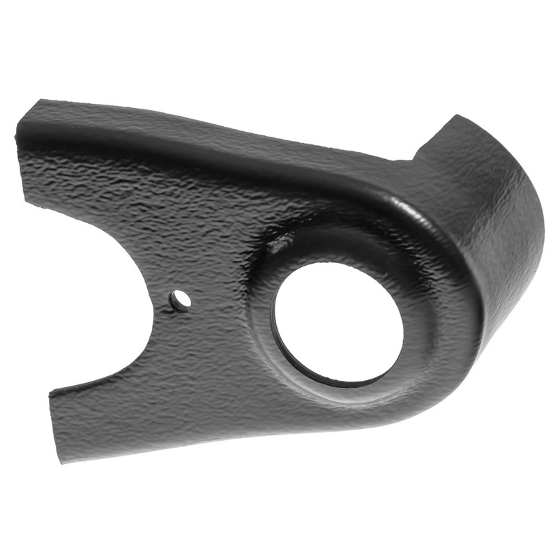

These covers are available from some of the usuals.....I assume to cover the metal bracket as shown above..i have read that there was never a Jaguar part number for these...anyway a good cover to hide up a home made bracket...or a laser printed one.......Steve

Looking into these brackets a bit further - the photo shown by Steve above shows the bracket I believe which was fitted to the S1.5 cars (and early S2) without the steering lock housing at the top of the upper column . As can be seen in Steve's photo the bracket has an additional tube which locates around the top of the column . This was removed on my bracket (which was an interim thing) when the steering lock casting was added to the column and the bracket is secured to the top face of it by three small screws. When the steering lock was used the bracket wasn't required. If the steering locks eventually become unavailable (I don't know if this is likely or not) this bracket could be used to retrofit to cars to use the separate switch and still look period - thats my take on it anyway.
