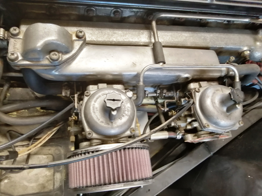

Hello All.
I'm converting my series 2 E Type to RHD and wondered what others who had carried out this conversion had used as an air filter for twin Stromberg's. Being a late series 2 I am unable to use the original air filter as its obstructed by the pedal box.
It seems I have 2 options fitting 2 K&N style air filters or the early series 2 plenum and canister filter. (would that clear the pedal box.?? ).
Which brings me to my second question. As l cant use my original filter I'm assuming l will have to remove all of the emission's do l just have to plug the pipe on the inlet manifold and change the oil breather cover to an earlier type.
Cheers Phil.

I'd suggest using the "early" - it's actually most of them - Series 2 plenum and canister filter is best. The canister filter assembly is available from The Usuals and given that there are many folks who convert to triple SU's you should be able to find a second-hand 2 carb. plenum for Stromberg's easily enough.
The K&N's whilst good filters will give you more induction noise and look out of place.
I have heard it's possible to modify your current air filter by cutting back on the part that fouls but difficult to do without looking a bodge.
With the standard plenum the engine crankcase breather pipe runs from the front of the timing chain housing to a fitting under the plenum. There's no inlet temperature control pipework to deal with.

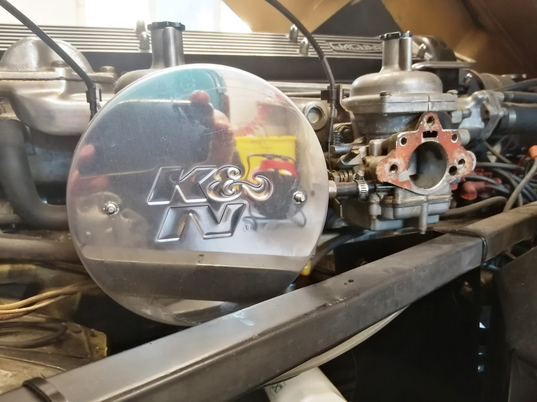

Hi Phil
By coincidence, just yesterday I received a pair of K&N Filters, but on trying to fit them found the front one will not go over the chassis rail (by at least half an inch)
I'm leaving mine as LHD, however also trying to replace the standard box air filter, like yours for something more interesting!
Does anyone know the benefit (or otherwise) of removing the secondary inlet manifold? Guess the throttle linkage would need modifying and water outlets blocked off.

#4 Re: Late series 2 air filter.
Hi Phil,
I converted my 2+2 to right hand drive and made the mistake of ordering K&N filters that didn't fit!
I ended up with fitting Ram-flo by Lynx filters to my Stromberg's..........look very smart as well.
Will try to download a photo if you want to see how they look?

#6 Re: Late series 2 air filter.
The dis-benefit of removing the secondary inlet manifold apart from the ones you've mentioned is that you end up with the carbs too near the cylinder head worsening the airflow and probably torque. The best compromise is just to remove (or wire open) the secondary throttles but leave the secondary manifold in place.

#10 Re: Late series 2 air filter.
Thanks for the picture, Tim. Are they the RF400 type - can't seem to find any UK supplier at the moment or did you get them directly from Lynx? There are some copy versions from a US supplier, but works out about the same price as the real thing!
Still need to do the inner butterfly modification and haven't really run the car without the original air filter yet, Phil. Will let you know later.
