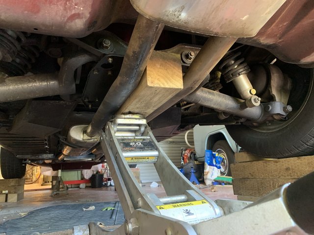

#4 Re: Rear Wood Jacking Spreder
Here’s mine:

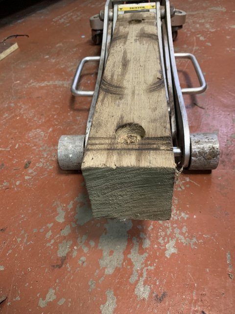

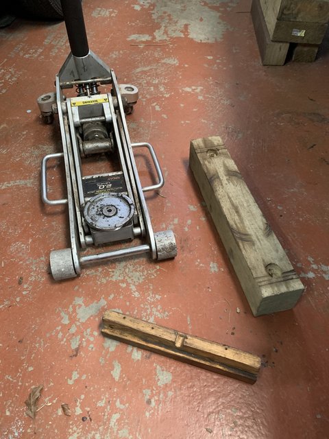

90mm x 90 mm, fits between the pipes and takes the weight square on. Two holes, but distance may vary depending on models - mines a Series 3 and the gap is 380 mm centre to centre. I just jacked the beam up a little bit and made impressions of the bolts on the base of the IRS, then drilled out with a flat blade hole borer.
The other piece is my front jack pad.

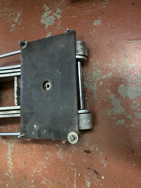

If the exhaust is off, then I replace the pad of the jack with this (shown balanced on the pad rather than firmly attached):
The bolts and flat washers fit close over the base of the IRS, then the pad is firmly bolted to the jack and the IRS is rock steady on the jack, can’t fall off, stays upright and can be moved around with ease and safety. Bolt centre distance is 305 mm ( longest side), the short side doesn’t matter so much.
All homemade. The beam is just an off cut of treated pine. Some say too soft, but it has served well for ten years or so.
Simon.

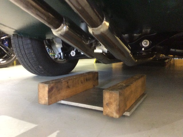

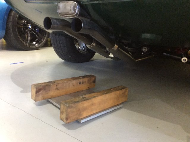

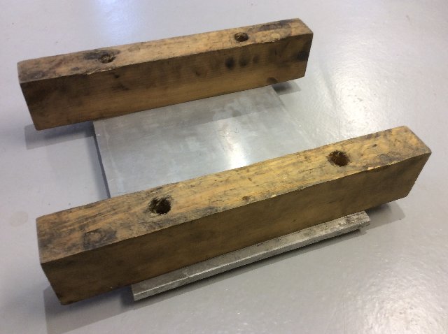

I have a simple jack plate which fits each side of the exhausts. The wooden 70 x 45 mm lifting supports just fits snugly each side of the pipes, with the wood picking up on the differential trunnion brackets.
Full text and previous post and other comments and ideas on rear jacking here :-

#7 Re: Rear Wood Jacking Spreder
As I was using the spreader today, I thought I’d show a photo in use. Really really simple, cheap and stable.
